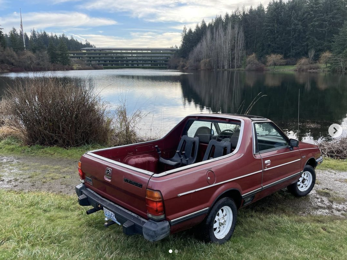

Here's a picture of my beautiful 1983 BRAT hanging out down by the old Weyerhauser headquarters by Auburn.
