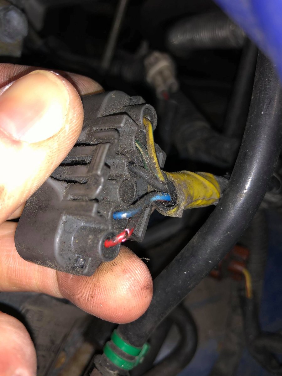

psv Posted January 28, 2021 Author Share Posted January 28, 2021 Update: I did some tests around the coil, igniter and the wiring. And when checking continuity, I had connection from the coil to the igniter with the red wire and the yellow wire, so all checks out there. However the blue wire going from the coil to the igniter had no connection what so ever. So before I start tearing down the wiring harness, I want someone to confirm thats not how it's supposed to be, right? The test was done when the car was off, with no key in the ignition. Hope my description was understandable Picture below is the plug for the igniter, I forgot to take a picture of the plug for the coil. Link to comment Share on other sites More sharing options...
psv Posted January 28, 2021 Author Share Posted January 28, 2021 Ok, so I put a wire between the ignitor and the coil to replace the blue wire and the car fired right up on all four cylinders. Thanks for all the help guys! Tomorrow I will find where the blue wire is broken and fix it. 1 1 Link to comment Share on other sites More sharing options...

heartless Posted January 30, 2021 Share Posted January 30, 2021 that red wire is going to give you problems in the near future as well.. has damaged insulation that is pretty obvious in the picture. 1 Link to comment Share on other sites More sharing options...
