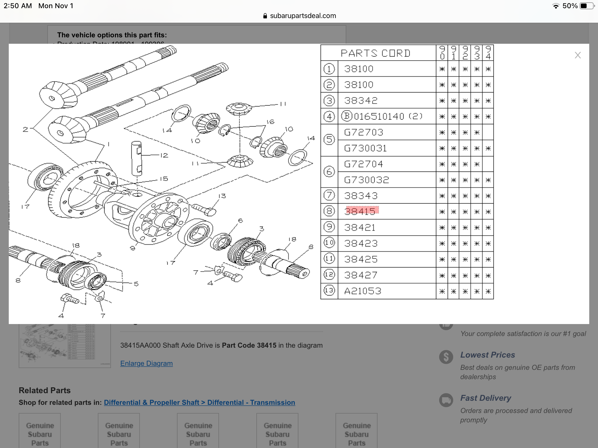

Moto7man Posted November 1, 2021 Author Share Posted November 1, 2021 (edited) Original parts for console have arrived. I have an issue on my 5MT 2WD transmission. Can the stub axles on both sides of the transmission be pulled out? Are they held in with a expandable snap ring or do I have to split the transmission to replace them? see attached screen capture, part #8. Edited November 1, 2021 by Moto7man Upload problem Link to comment Share on other sites More sharing options...
el_freddo Posted November 1, 2021 Share Posted November 1, 2021 Split transmission to remove the circlip that holds the diff stub axle in place. No other way to do it other than brute force - and lose the circlip in the box. Not what you wanted to hear I bet. What’s the issue with that stub axle? They’re pretty tough things! Cheers Bennie Link to comment Share on other sites More sharing options...
Moto7man Posted November 2, 2021 Author Share Posted November 2, 2021 That is what I thought. I am going to check them tomorrow. I am just going through a final once over to make sure everything is ok. I think they are probably fine. Link to comment Share on other sites More sharing options...
