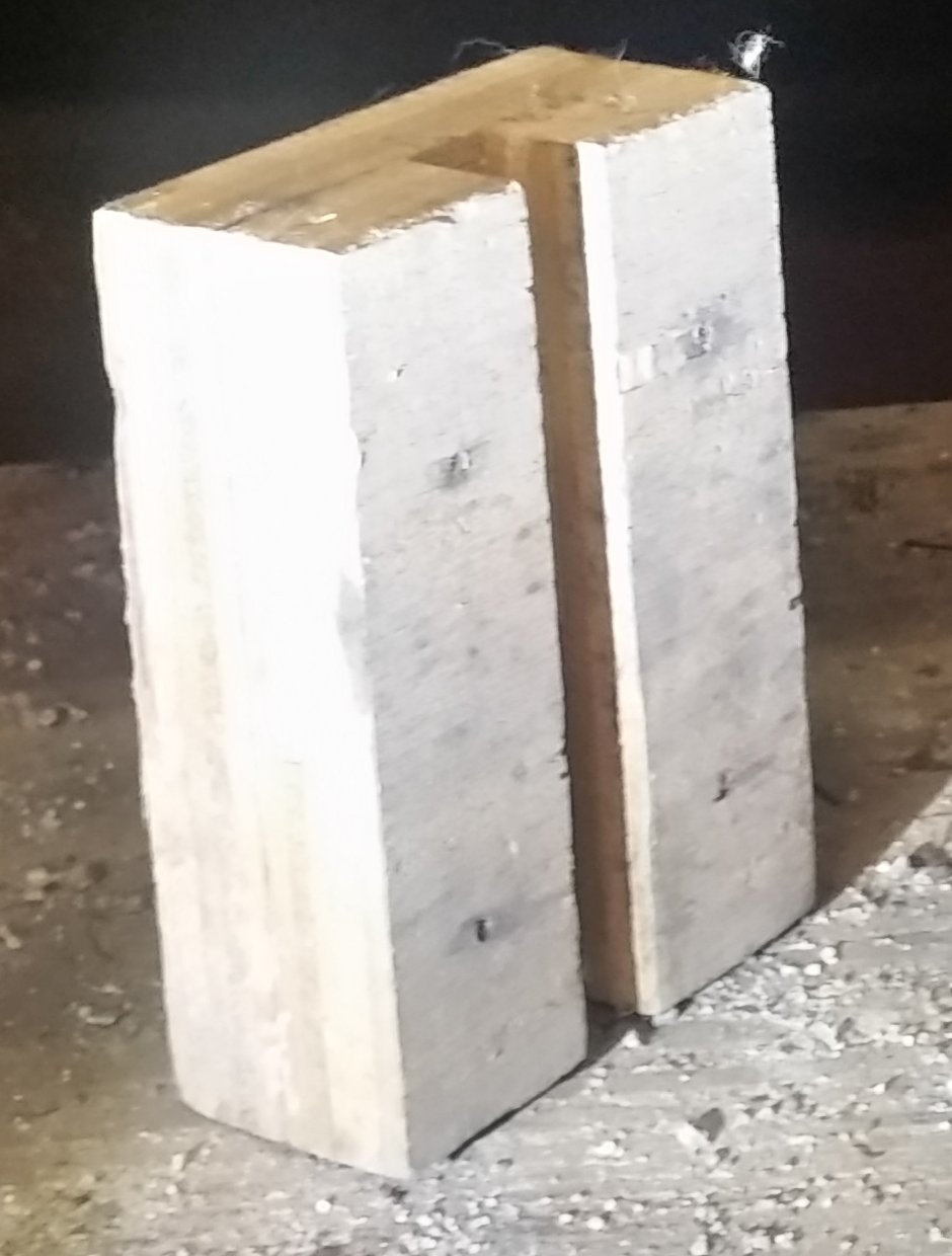

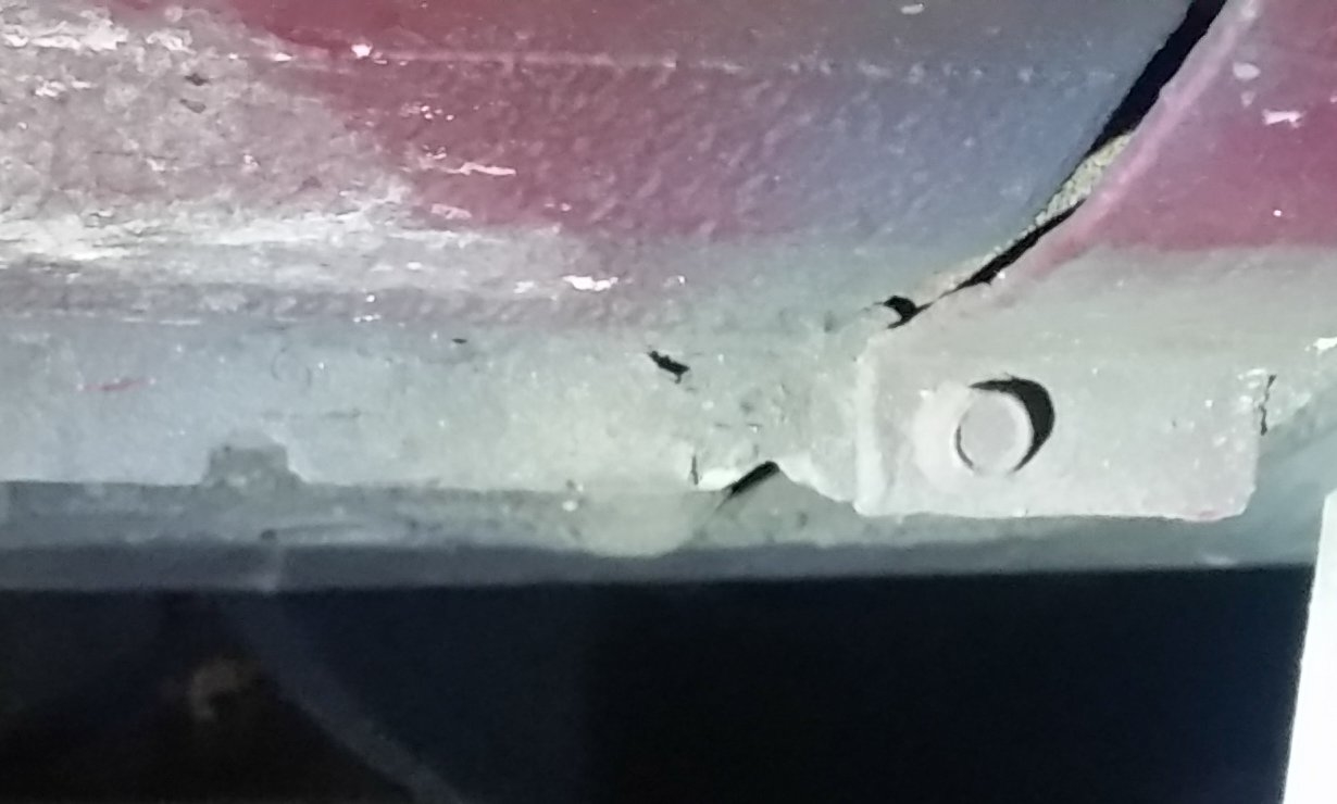

2003742646_JackBlock.jpg.a6e95acddd8392c0e855dfe6c8bba287.jpg1475085983_Jackpoint.jpg.938a03c38c0aef82c07454d3d81c6dda.jpg
The top pic is a jack block I made from plywood.  The bottom pic is the proper front jack point.  Notice the 2 little notches in the pinch weld.  Between them is where you put the Subaru jack.  There are a similar pair of notches back near the rear wheels.

Those notches on the pinch weld of the rocker panel are where the factory subaru emergency jack go... true it is made to handle the weight of the car as long as The Rust hasn't gotten to it.
