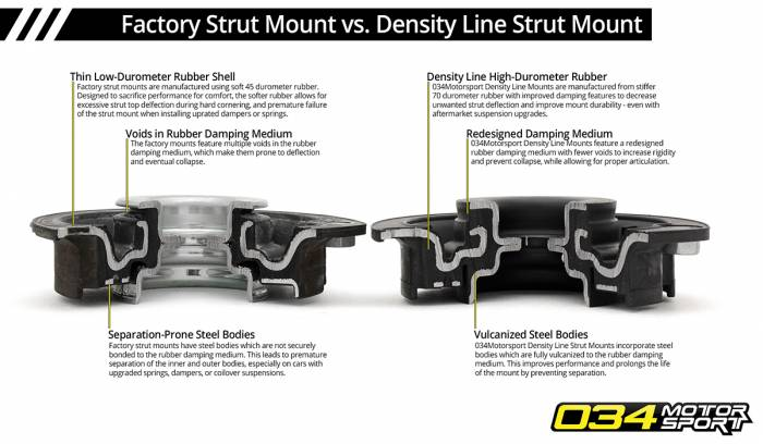

1 Lucky Texan Posted April 10, 2021 Share Posted April 10, 2021 well, I'm not certain OK, but I think they are separated by vulcanized rubber, but there are metal 'cups' or w;'eevr that overlap each other such that a rubber failure will not allow a strut to shoot thru your hood. Link to comment Share on other sites More sharing options...
1 Lucky Texan Posted April 10, 2021 Share Posted April 10, 2021 looking at the following as an example. I suppose, if you could get the window weld in all the right places, free of voids, you could get something useable for at least a short period of time. Link to comment Share on other sites More sharing options...
Ionstorm66 Posted April 11, 2021 Author Share Posted April 11, 2021 The loyale ones are different. The is a cone shaped steel mount that bolts to the car, and the rubber fits inside that. There is no way for the rubber cone to go through the steel mount into the hood. It could become unloaded, and fall downwards. 1 Link to comment Share on other sites More sharing options...
