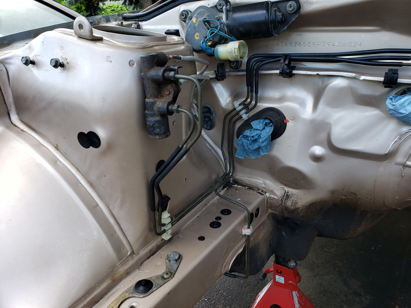

Hey all, figured i post here while I'm looking around the internet. I have 93 Subaru legacy that's developed a weird random misfire issue. I'll be driving sometimes and shell be fine, other times it vibrates like hell and sounds like trash, and then it suddenly goes away. I just took the engine out of the car to clean off all the 300K dirt and oil that was on there, replaced the intake gasket and put on an aisin timing kit, and threw the engine back in. At first i thought the issue was a bad alternator, (my alternator was bad), but it turns out this isn't the issue. Crank and cam position sensors were replaced last year as well as a fresh set of NGK plugs and wires. I've read that sometimes the oil pressure sensor can leak onto the crank position sensor so I'm going to check that, and make sure everything is tight but if anyone has any ideas they would be greatly appreciated, thanks for any help.

yes the random is the worst part, and yes 93 is pre-OBDII, not only that but my car has been manual swapped so i have a check engine light 24/7. I tried to see if anything was lose and the only thing i could come up with was the coil pack, but I don't think it was lose enough to cause any wires to come undone. Regardless, tightened that up and went on a drive around the block and it was running right as rain but I have a sneaking suspicion its not the culprit. Hopefully I'm proven wrong. As I said though it is intermittent. I have no idea what causes it to start or to stop, sometimes a good rev to almost redline will make it fine, other times ill get home and it'll just not stop, yesterday I drove down the highway for 5 minutes and it didn't stop till I stopped a stop light a minute from my house.

I refreshed a decent amount of the grounds a year ago when I did the awd manual swap but ill look again. the only symptom that ive seen, yet again a random one, is that sometimes ill be driving and the check engine light will flash, and for the faintest second the rpms drop to 0 the rocket back up to where they were. besides that radio works fine, I have a aftermarket rad that I had to wire myself but that's also fine. one thing ground wise, the grounds toward the front of the car on the lower flat bar of the engine bay, they would be right in front of where this picture ends if that makes sense(that was a crap description but idk how else to explain), i believe they are for the oem rad, I do have those unhooked because my rad has its own grounds, could that possibly be the problem? I figured because there's no rad in the car it would be a big deal but now I'm not too sure.

It’s unlikely the grounds anyway. Almost every Subaru I see and drive has corroded and detached grounds and runs fine. Yes they can be problematic but that pic looks like a clean car, engine came out and you had a good look at it and it starts.
