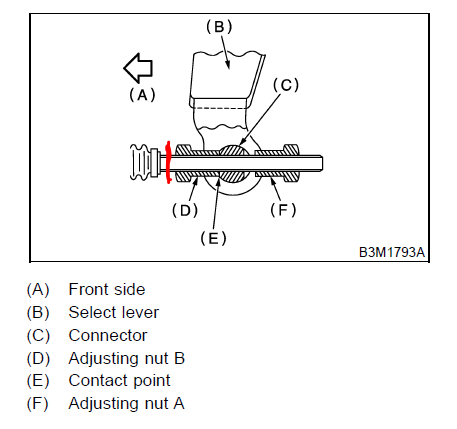

Numbchux Posted May 24, 2021 Share Posted May 24, 2021 Yep, there's a little bushing between the shifter arm and the cable that is usually seized in there. There are 4 or 5 different numbers over the years, but the dealership I worked at stocked them, as it's a fairly common failure in this part of the world. 1 Link to comment Share on other sites More sharing options...
heartless Posted May 24, 2021 Author Share Posted May 24, 2021 3 hours ago, Numbchux said: Yep, there's a little bushing between the shifter arm and the cable that is usually seized in there. There are 4 or 5 different numbers over the years, but the dealership I worked at stocked them, as it's a fairly common failure in this part of the world. yeah, I can just see white plastic at the joint.. no way that is going to clean up and be usable - just ordered the bushing and the lower bracket as well. might as well just get the parts & replace it all in one go rather than spending hours trying to clean it up and having to order the parts anyway. Car is gonna be down for more than a week as it is.. Link to comment Share on other sites More sharing options...

heartless Posted May 25, 2021 Author Share Posted May 25, 2021 so apparently there IS a supersede (several generations) beyond the one that is no longer available... and it fits my car... in fact, it fits over 1000 different variants of Subaru from 1987 onward. Only major difference i can see is price, most likely due to differences in material used to make it. And they do carry it so we shall see if they offer it to me... if not, I have it in a cart on another site, for a few cents less... LOL I am still interested in seeing what you have, Larry - see if it might work. Link to comment Share on other sites More sharing options...
Numbchux Posted May 25, 2021 Share Posted May 25, 2021 Have you talked to an actual dealer parts department? I don't believe for a second that those are not available, we sold them all the time. But sometimes there are some oddball supersessions. Link to comment Share on other sites More sharing options...
heartless Posted May 25, 2021 Author Share Posted May 25, 2021 1 hour ago, Numbchux said: Have you talked to an actual dealer parts department? I don't believe for a second that those are not available, we sold them all the time. But sometimes there are some oddball supersessions. oh, i found the most recent version of it, on another subaru parts site. doing a google search for the part number came up with it - the newer part is listed as being for the Crosstrek, but when you go down to where it lists fitment, that is where you find out it fits over 1000 different Subaru models, across many years, starting in 1987 - and yes, my 2002 Forester is one of them, lol 1st site was subarupartsdeal - they have not offered me the updated part (even tho they carry it), or even mentioned it existed. Order there has been cancelled I found the updated part on Subarupartwholesale - updated part is more expensive than the old one (almost double), but it is what it is.. the part is needed, period. Link to comment Share on other sites More sharing options...

heartless Posted May 26, 2021 Author Share Posted May 26, 2021 yeah.. i have yet to get back out to the garage to get pictures.. but the number one location for problems is gonna be that swivel joint on the shift lever and possibly the cable itself if the boots are damaged. Larry - I got the pics, and yeah.. not gonna work.. wiring is different and mine has 6 screws, not 4, so.. thank you anyway. (mine is the older version, straight pattern, not gated) otherwise, yeah, that looks like a nice unit - so if someone needs one, hit him up! Link to comment Share on other sites More sharing options...
