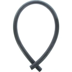

ThosL Posted July 14, 2021 Share Posted July 14, 2021 (edited) I was planning a 60 mile or so trip earlier and unfortunately I noticed temperature indicator going up. After pulling over to the side of the road, it looked like the 1997 2.5 was down a lot of coolant. I stopped at a convenience store and filled up a gallon jug with hot water and poured it in after letting the car cool down. I checked underneath and sure enough the one inch or so hose coming off the thermostat housing had sprung a leak. I'm glad I caught it and was still able to drive it back to parking to address it in the morning. The smaller hoses can be hard to catch; I had one less than finger width go in a 2.2 engine on top of the engine and blew the engine. More likely in the hot weather we have been having. The hose looked like it has a curve in it, anyone know the ID on that? Thanks. is it the engine coolant bypass hose? If I duck tape it up will that buy me enough time to pick the part up and install it? Edited July 14, 2021 by ThosL Link to comment Share on other sites More sharing options...

1 Lucky Texan Posted July 14, 2021 Share Posted July 14, 2021 (edited) if you can't match it, as an emergency measure, see if you can make a bigger 'loop' with straight generic hose. Smallest 3/4 circle that doesn't kink. Tie/support it out of the way with some cord or zipties strung together.....? like this ____( Edited July 14, 2021 by 1 Lucky Texan 2 Link to comment Share on other sites More sharing options...
Numbchux Posted July 14, 2021 Share Posted July 14, 2021 Typically listed aftermarket as a bypass hose, but it's actually inline with the heater hose circuit. Crucial to thermostat operation. Since it's such a simple hose with a bend, most parts stores stock one that will fit (sometimes with some trimming). If not, there are self-adhesive silicone hose repair tapes that work fairly well for emergency repairs. I try to keep a roll in my cars most of the time. 1 Link to comment Share on other sites More sharing options...
ThosL Posted July 14, 2021 Author Share Posted July 14, 2021 (edited) Frankly I think a comparable straight, not molded hose would have served just as well. Is there any evidence to the contrary? At any rate, I went down to NAPA in Norwalk after calling them that said that they had the Dayco #87964 in stock which ebay listed as the right part. Their computer however showed a different part they did not have in stock. I worked on the car down the road in a parking space at the library. Pulling the main hose going into the thermostat is essential. The hose clamps you get off with pliers can be hard to work with. I replaced one with a standard hose clamp from NAPA. I'm not sure I got the orientation of the hose accurately aligned, I have never been good with that sort of thing. I put in a gallon of Auto Zone antifreeze, I will watch it more closely for future leaks. Would it be good to spray down other hoses that may have been compromised by oil leaks falling on them? Edited July 14, 2021 by ThosL Link to comment Share on other sites More sharing options...
heartless Posted July 14, 2021 Share Posted July 14, 2021 1 hour ago, ThosL said: Frankly I think a comparable straight, not molded hose would have served just as well. Is there any evidence to the contrary? because of the short distance, standard straight hose will kink (been tried), unless you do like Texan suggested and make a loop to prevent kinking. 1 Link to comment Share on other sites More sharing options...
