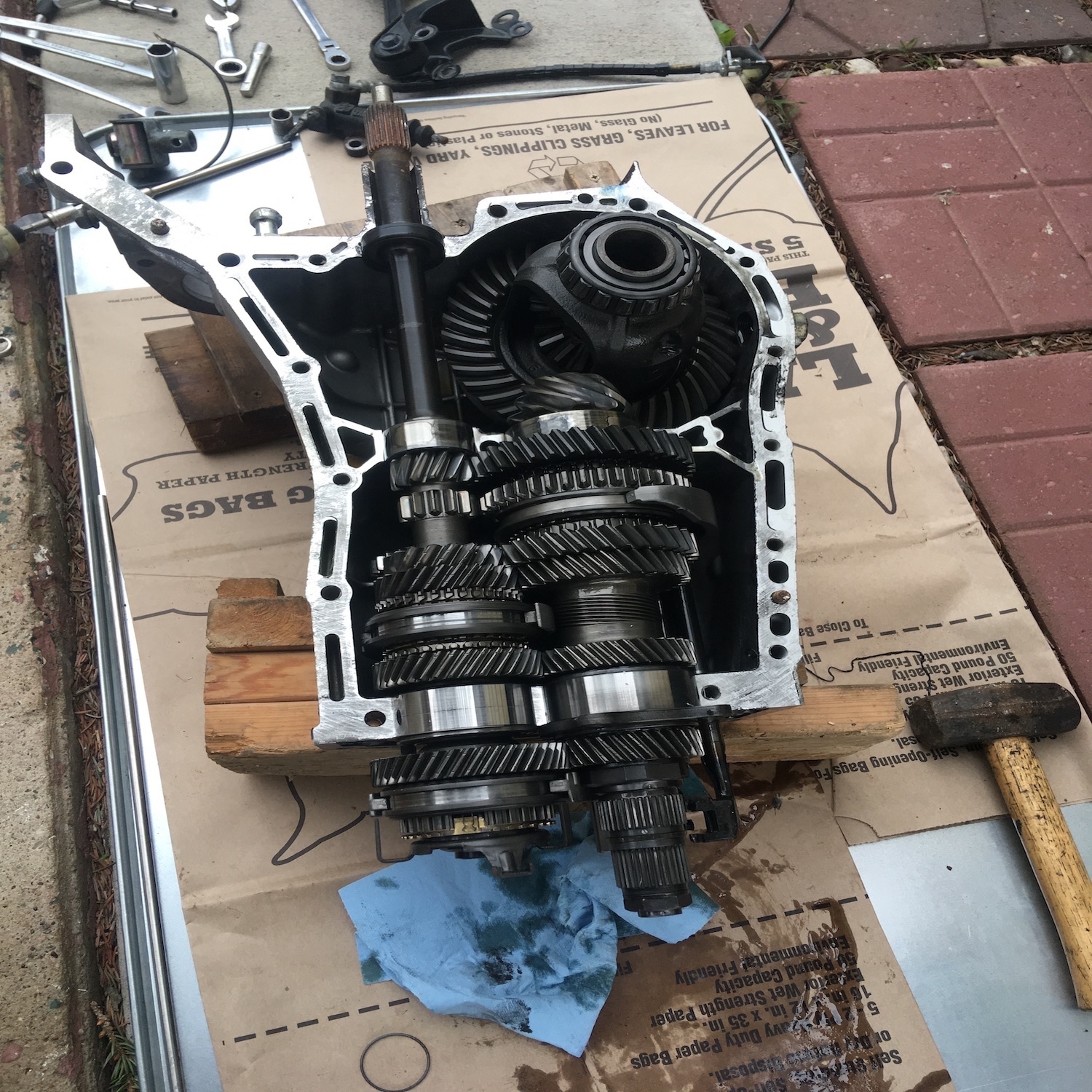

I bought a 5mt from a JDM '05 LGT wagon, and swapped in the stub shafts and speedo gear for my '98 Outback. Splitting the case and removing/reinstalling everything isn't that bad, honestly. I've got 10 thumbs and I didn't think it was too bad. There are a bunch of write-ups on splitting the case...
https://www.voisin.ch/subaru/docs_techniques/2008_impreza_wrx_&_sti_manuel_atelier/wrx/wrx_transmission/5mt_manual_trans_&_diff.pdf
Once it's open, the ring/pinion gear are easily accessed, and removable...
hope any of this helps!
