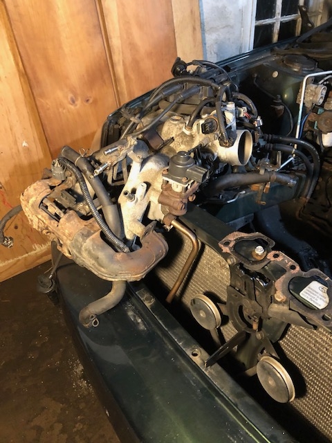

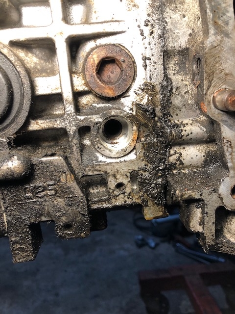

moosens Posted August 9, 2021 Author Share Posted August 9, 2021 (edited) Man that Allen head plug sits right above the port I’ll be making. Why couldn’t it be that easy ? LOL faaaack ! Closer now. Took the intake off today , have it all free and the crane/hoist over it with a spreader bar ready to lift. I’ll have a buddy with me or my daughter and then proceed. Edited August 9, 2021 by moosens Wrong Link to comment Share on other sites More sharing options...

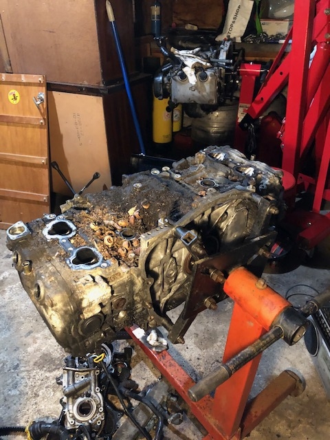

moosens Posted August 11, 2021 Author Share Posted August 11, 2021 Small step forward but that’s life lately. Engine out. Didn’t see that one nut hiding. Once done she split like a dream. Minimal effort with flat blades and chisel. Boring stuff I know. But man this sucks that they didn’t put a plug where that EGR apparently needs to sit. So I’ll be scoring that tap with at least one drill. I’m sure I have plenty to use for a pilot drill. GD if you’re checking in I’m guessing a good prick punch to start a healthy center ? And all drills will have tape on them as deep as the fitting it with maybe a 1/16” ease. Link to comment Share on other sites More sharing options...
GeneralDisorder Posted August 13, 2021 Share Posted August 13, 2021 I don't center punch them but you can if you like. Centering the through hole isn't critical though I have done lots of drilling to remove broken fasteners over the years and have a keen eye for center. GD Link to comment Share on other sites More sharing options...
heartless Posted August 14, 2021 Share Posted August 14, 2021 i do hope you plan on doing the headgaskets on that while it is out.. that line of oily sludge going up the joint is just screaming for attention. Link to comment Share on other sites More sharing options...
