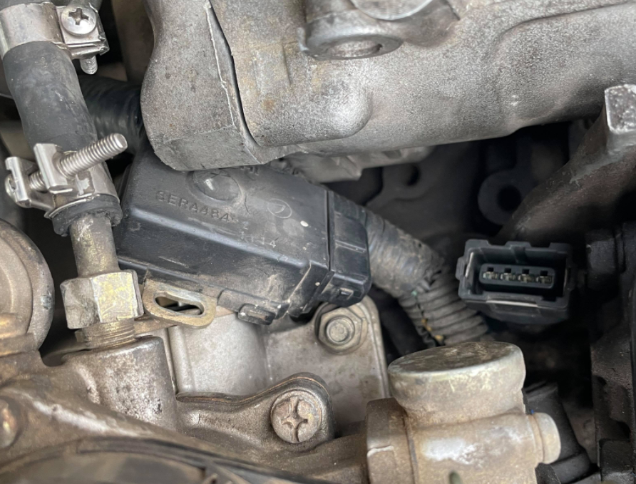

Phil Hyde Posted August 17, 2021 Author Share Posted August 17, 2021 Link to comment Share on other sites More sharing options...
DaveT Posted August 17, 2021 Share Posted August 17, 2021 I just took a look at my 2. And remembered that the TPS I took apart was on an intake that was off the engine. I would unbolt the A/C compressor, and swing it out of the way if I had to get one off an assembled engine. The hoses are long enough. Link to comment Share on other sites More sharing options...
somick Posted August 17, 2021 Share Posted August 17, 2021 As far as I remember you are correct. Either the throttle body needs to be removed or the AC compressor. But if you unplug the connector you can test in place. There is a testing procedure in the FSM Good luck, Sam Link to comment Share on other sites More sharing options...
Phil Hyde Posted August 17, 2021 Author Share Posted August 17, 2021 34 minutes ago, somick said: As far as I remember you are correct. Either the throttle body needs to be removed or the AC compressor. But if you unplug the connector you can test in place. There is a testing procedure in the FSM Good luck, Sam I did do the test procedure. My sensor is failing the first test, which is continuity between A-B when closed or part throttle. I was not able to adjust the sensor CCW, so I am going with the theory that the sensor is faulty. Link to comment Share on other sites More sharing options...

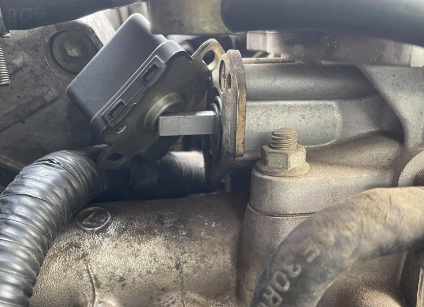

Phil Hyde Posted August 18, 2021 Author Share Posted August 18, 2021 To circle back to my first question - I was able to get the sensor off by removing the A/C compressor (which is kind of a bear of a task). 1 Link to comment Share on other sites More sharing options...
Step-a-toe Posted August 18, 2021 Share Posted August 18, 2021 i wonder if you could remove 3-5 mm off the end of the throttle shaft to allow easy on - off for future tinkering? Link to comment Share on other sites More sharing options...
