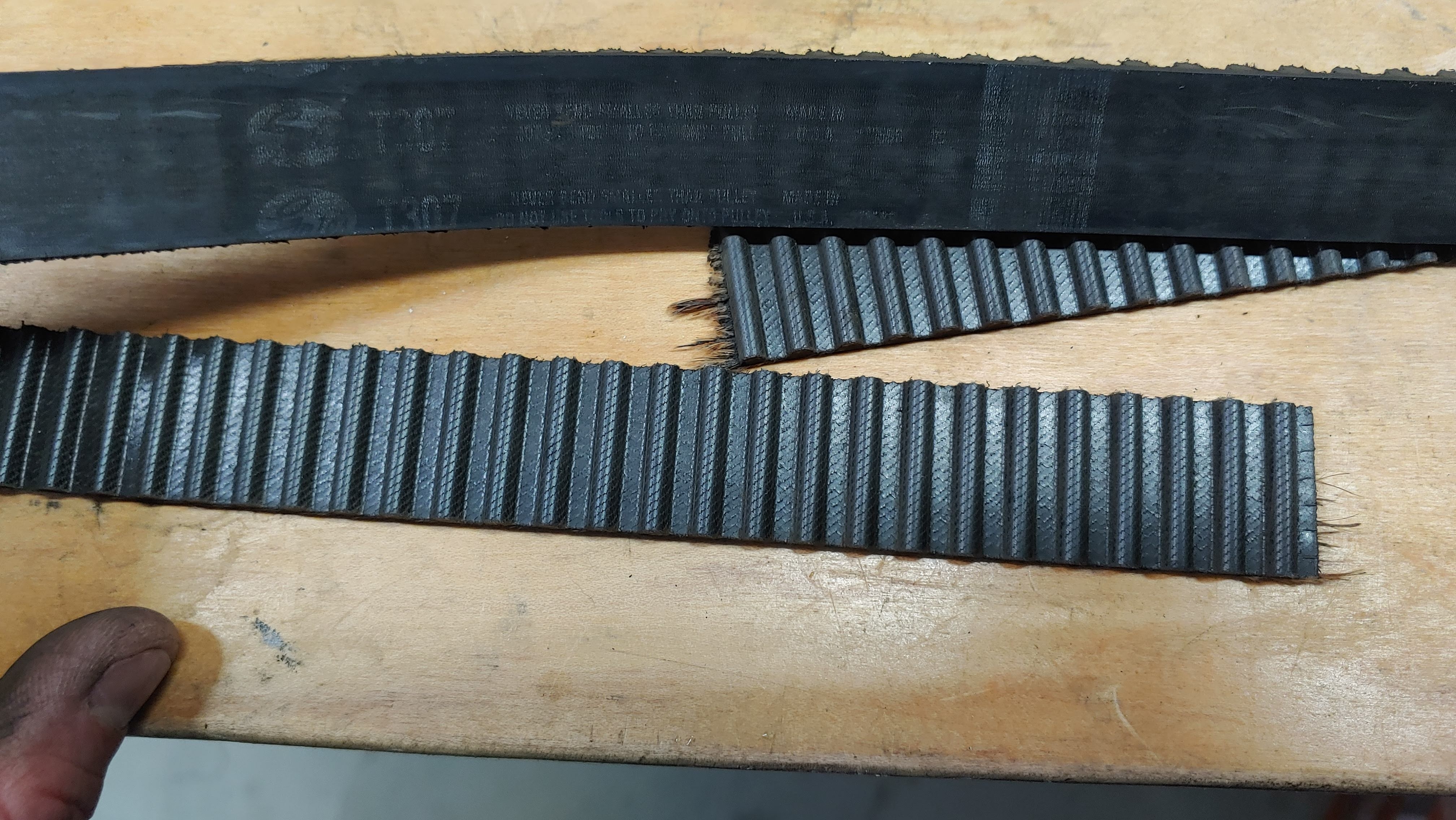

1st question-  What causes the timing belt to snap?  Belt was a Gates, had 70k and 6 years of use.  Short of the factory 105k or 105 months spec.  Belt has no obvious wear, missing teeth, cracks, etc.  Just a snapped. All idlers, tensioner, and WP were replaced 50k ago and were in good shape.  Engine turns over by hand now with a new belt installed, so I don't think anything is seized up.  Is there anything I should be on the look out for or just chalk it up to a bad belt?

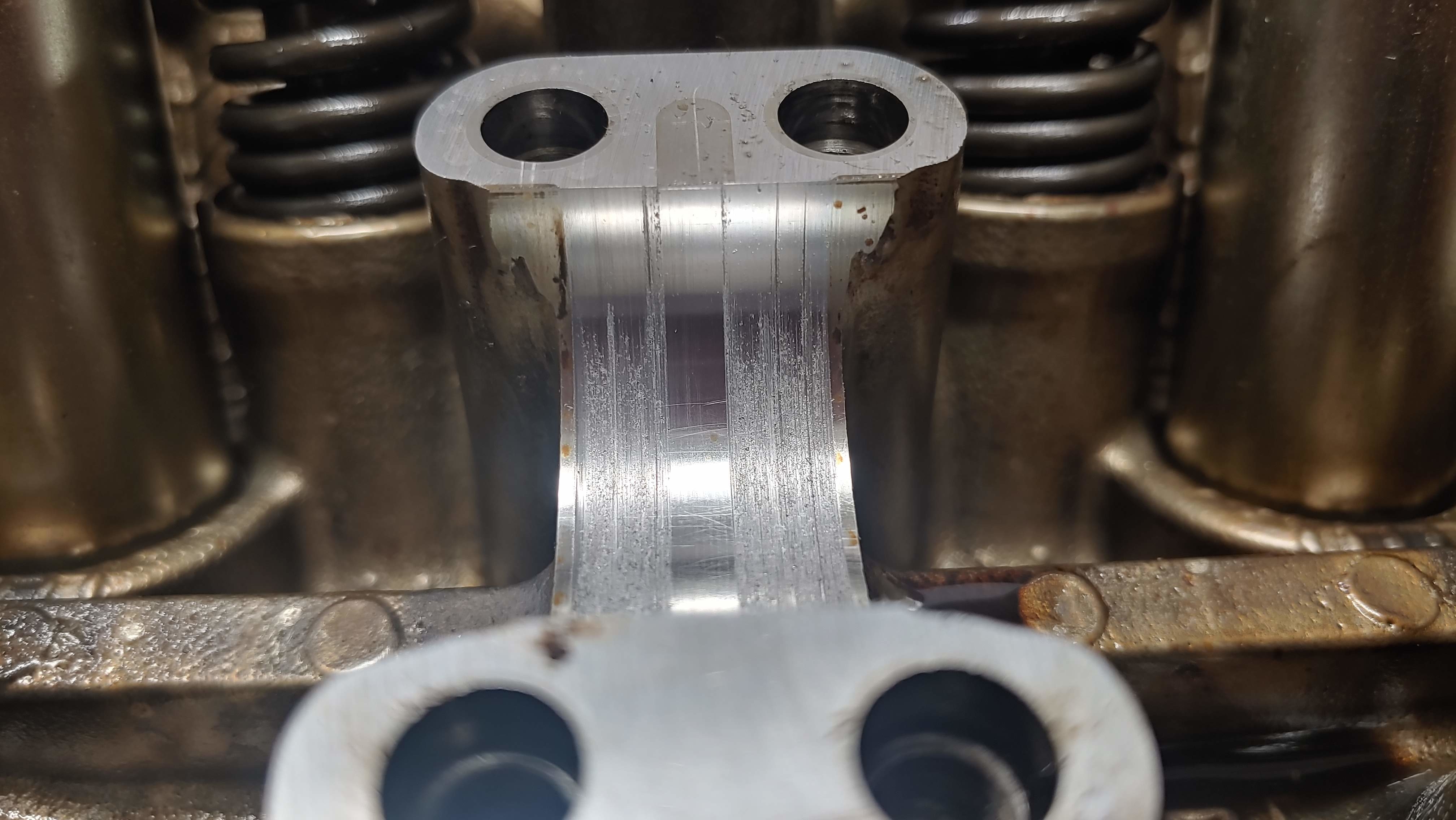

2nd question-  I got a pick n pull motor last weekend. After bringing it home, I discovered it's got a bad rod bearing on #1.  The valves appear to still seal well (10% on a leakdown test, ~75psi on a hand cranked compression test), but the cam journals are in pretty rough shape (pictured).  What's the most cost effective approach here?  Are those valves still good?  Could I swap the valves over to my heads?  Have a machine shop repair the cam journals?  If I swap the valves over, should I pay the machine shop for another valve job or can I get good enough results if I lap them by hand?
the belt is a quality issue, and sadly, Gates has gone downhill in recent years - i wont use them anymore for timing.
Mitsuboshi is the OE supplier and preferred brand for timing belts on these cars.
Aisin for water pump, NSK or Koyo for idler pulley bearings, and NTN for the tensioner assembly. These are all OEM parts and what is recommended
We have two pick-n-pull yards here, and why you'd want to do all that expensive and high-hassle messing with that head - rather than just returning it to them for an exchange - is beyond me.  Take it back and get one without the trashed journals.

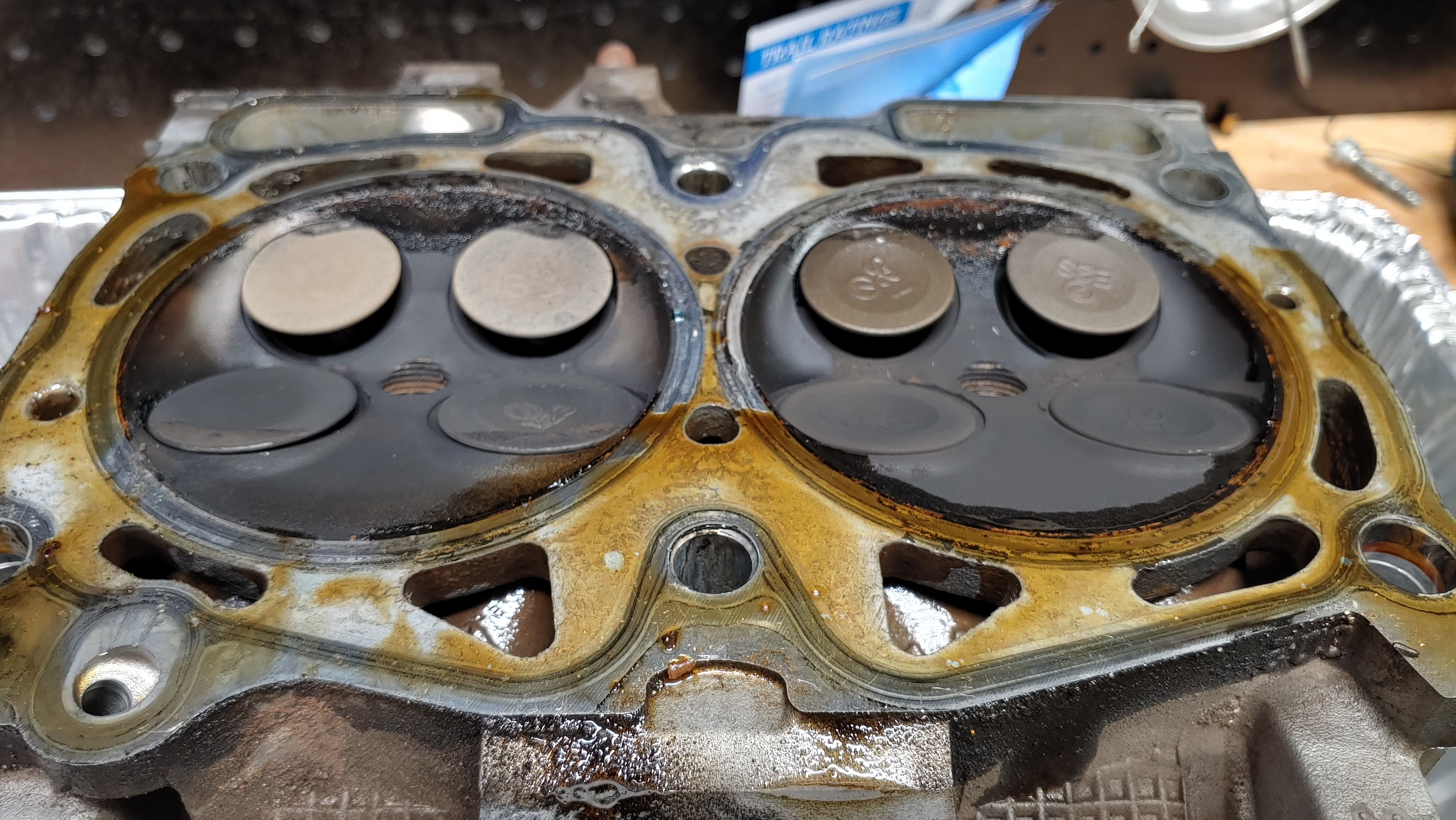

Photo of the carnage.  All but 4 intake valves were bent.  Junkyard valves seem to be in good shape, no pitting, some carbon deposits. Going to try lapping and testing to see if I can avoid a valve job at the machine shop.20211002_122051_HDR.thumb.jpg.50a3ff955aefc523655627085e86d987.jpg

Got around to testing the heads and assembling them this week.
One of the intake valves was leaking when I did the acetone+compressed air test, so I took it back to the machine shop.
He said something along the lines of if he had known I would be testing them after he was done, he woulda done things differently.  He did say that once the motor "was fired up, they'd seal right up".  He's kinda one of those old school guys, so I don't know.  He has good reviews on Google & Yelp, and I've heard a few good things about him through my friends.
He lapped the valve that was leaking, I took the head back home and reassembled the motor, using the Fel Pro MLS gasket kit.
I did a leak down test, I was getting about 10-15% on every cylinder, which is higher than I would expect (I was getting 8-10% with the junkyard motor).  So I guess I'll find out after I install the motor if he's right about things "sealing right up".

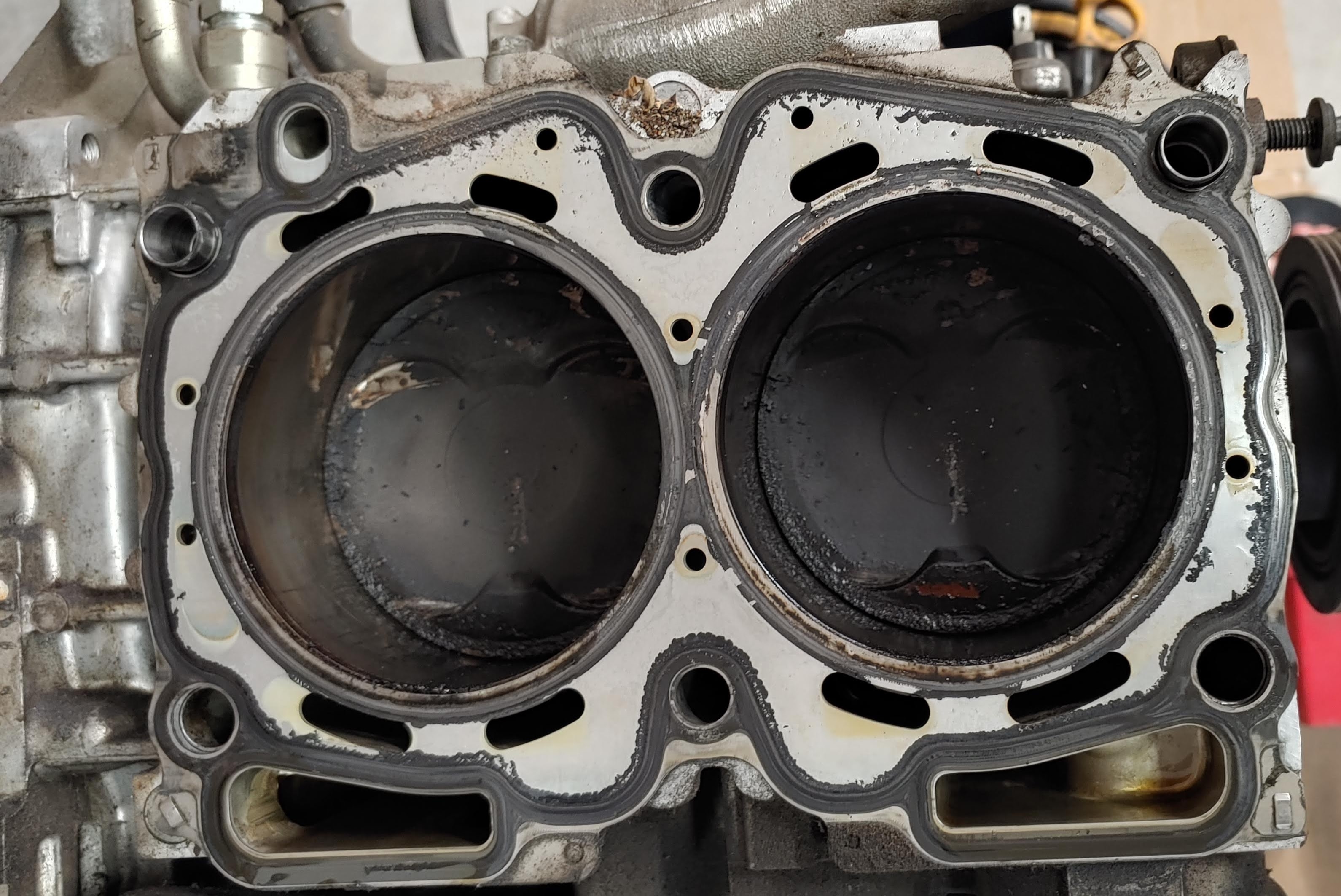

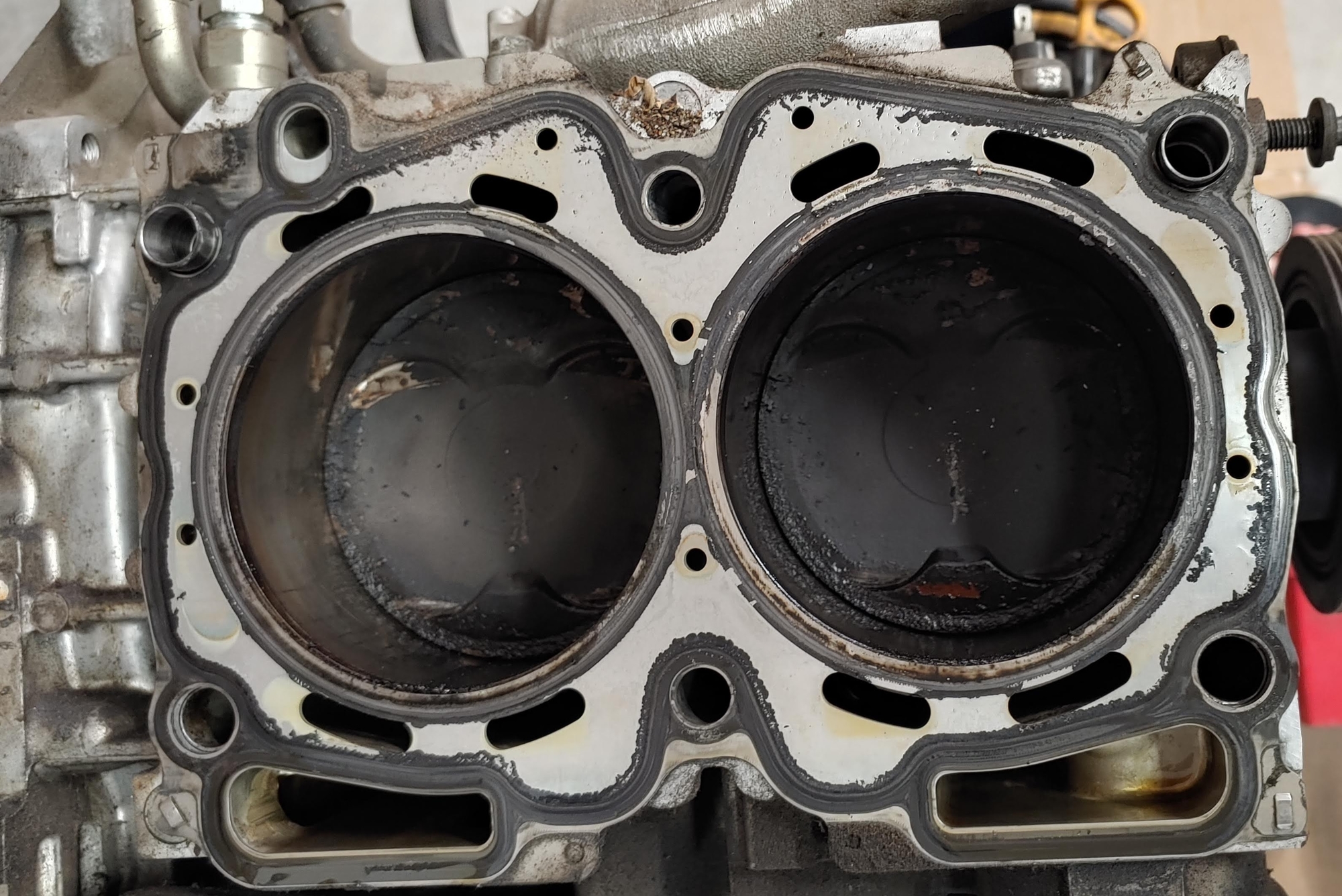

Pistons look pretty black and wet. I would be doing rings. NPR rings are cheap. DO NOT hone it. Just clean the pistons and install new rings.

2 hours ago, jamesm113 said:
The motor is back together now and I was planning on dropping it in tomorrow.  What causes the pistons to look black and wet?
I don't know if I'm missing something else with your move involved multiple engine/previous work scenario but oil blowing past the oil control rings.  Or a massively hosed PCV system but I doubt that's the case here.

Belt was a Gates,
That's the issue. They might not be horrible but they have a higher failure rate.

Yeah, my PCV valve was also 50k old...  I am replacing it with a new OEM PCV valve during this rebuild.
Car history - bought the car with 145k.  Noticed that it had a slight overheat condition going up hills, etc.  I never allowed it to go past 3/4 of the way up the temp gauge (~230F), but have no idea what the PO did.
While troubleshooting overheat condition, noticed HG's leaking oil externally.  Thought I should do HG as perhaps it was related.  Pulled motor and dropped the heads off.  The machine shop reported the exhaust valves were shot (pitted) and the driver head was cracked on one cylinder between the valve seats and spark plug hole. Also replaced the piston rings per GD's advice.  Replaced all driver head, exhaust valves, had valve job done, put the car back together, still was overheating.
Ultimately, I figured out the overheat issue 500 miles after the rebuild by doing a thoroflush brand chemical flush and replacing the radiator with a denso radiator.  I do not think the head gasket failure was contributing to overheating.
