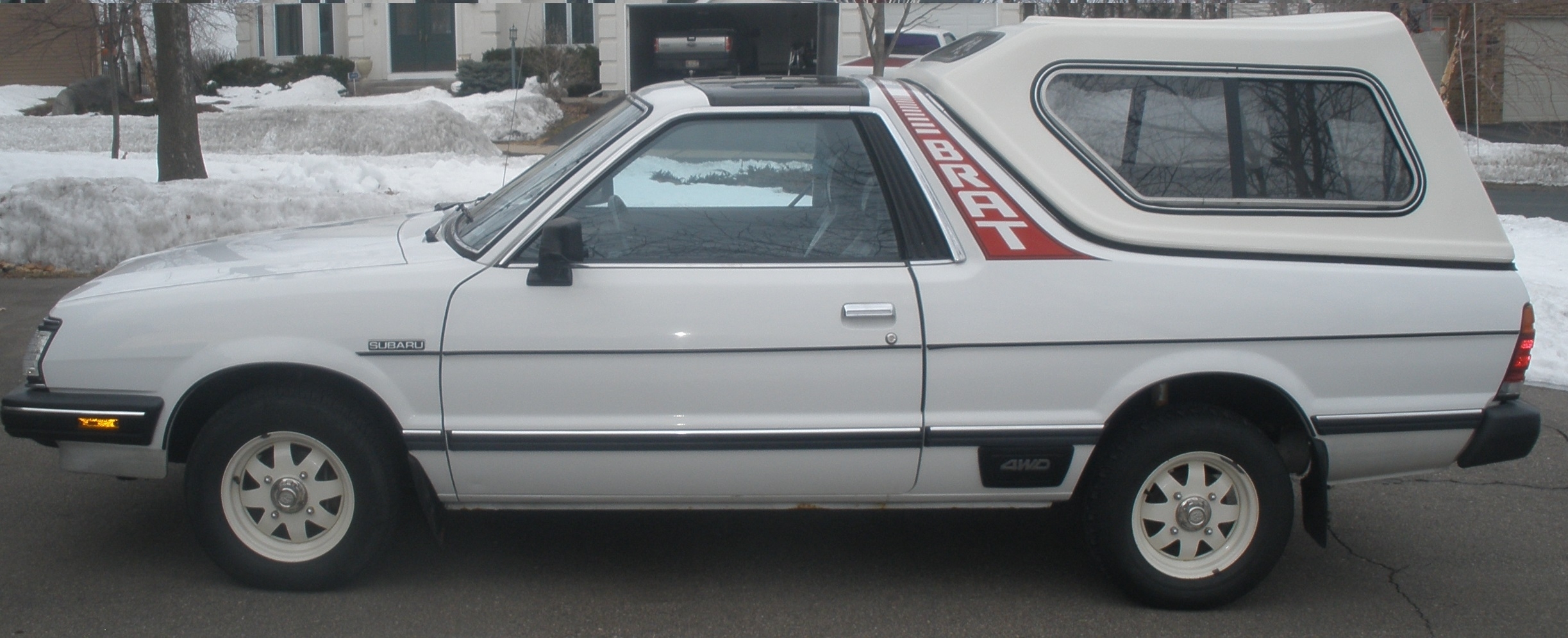

franbev Posted October 4, 2021 Author Share Posted October 4, 2021 Sorry, my '85 BRAT. There's a crack in one of the fins that I'd like to fix or replace. That black part just behind the driver's window. It's a left hand drive. Link to comment Share on other sites More sharing options...

Step-a-toe Posted October 8, 2021 Share Posted October 8, 2021 I have removed these in the past, twice, left and right. I see the two screws, but also see that the chrome surround trim is also integral. Like you, I sort of think it should just come off after the two screws, unless someone bonded with some gooey stuff? Not a heat gun, but maybe hair dryer to warm things up a bit. From the look of the snow, maybe iced together ? Link to comment Share on other sites More sharing options...
franbev Posted October 8, 2021 Author Share Posted October 8, 2021 That's an old picture, but the cold weather will be coming soon to Minnesota. That's why I wanted to fix the "air vent grill" before I put the Brat away for the winter. I only see two screws though, are the other two inside? Link to comment Share on other sites More sharing options...
