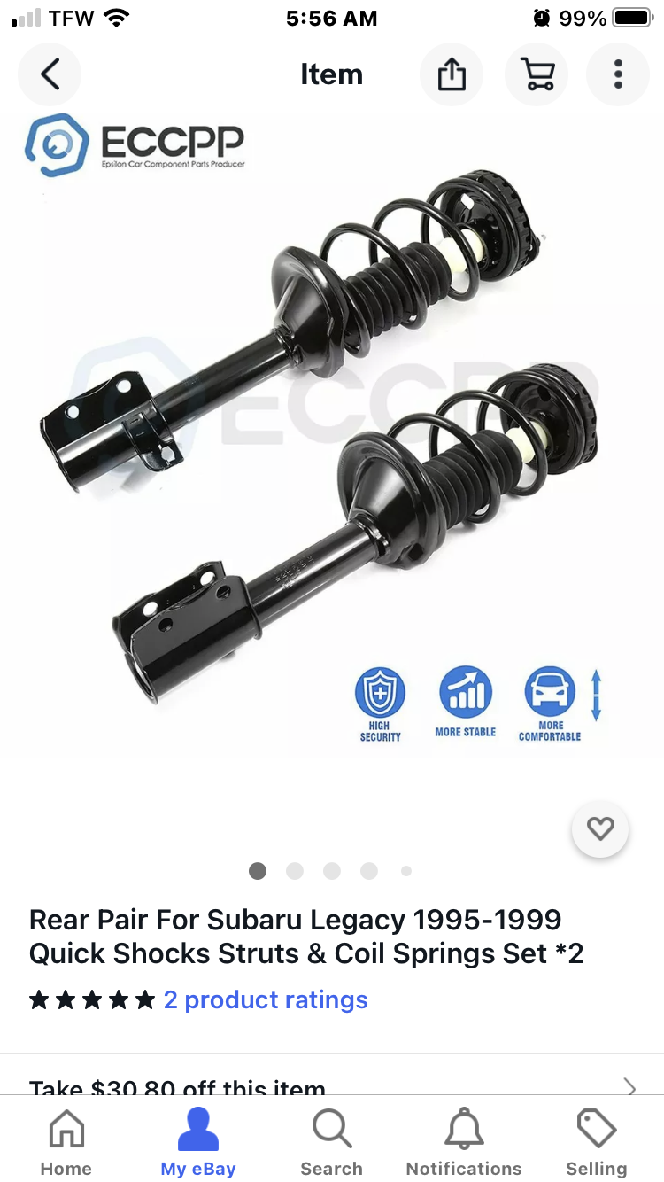

BrianT Posted November 2, 2021 Author Share Posted November 2, 2021 14 hours ago, heartless said: yeah, not gonna happen.. not anything worth putting on the car anyway. KYB struts.. either rent a spring compressor, or get the assemblies out of the car and take them to a local independent shop and they might do the spring swap for you for a small fee. Shop near us only charged like $25 to do the 2 fronts on the other half's Outback What is odd that these and a few others listed on EBay for a 95-99 Legacy apparently won’t fit a 95. I know the quality isn’t there, but the car has 280,000 thousand on it and this will probably be its last winter coming up. I just wanted something quick to toss on with the new snows.The seller canceled the order because even though they list as a 95 they won’t fit. Link to comment Share on other sites More sharing options...
idosubaru Posted November 2, 2021 Share Posted November 2, 2021 Trashy ride. Car angled like a demon. They could easily fail completely soon. Top mount could fail in less than 100 miles. Maybe they’d last…but Not worth it. I’d rather drive trashy old struts and wear a bike helmet for my head slamming the ceiling for a winter than install that garbage a shop can just swap the struts out, take them thr old assembly and new struts. you can do the assembly swap yourself and a decent shop shouldn’t charge much just to swap a strut into an assembly. 2 Link to comment Share on other sites More sharing options...
