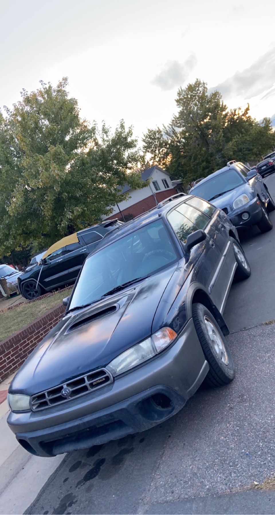

albert_tevs2020 Posted December 17, 2021 Share Posted December 17, 2021 Hello I need help I'm fist time Subaru owner yesterday my Subaru Outback overheated like redlined it than shut off in November we changed water pump thermostat and gasket radiator and hoses What else could be the problem? Quote Link to comment Share on other sites More sharing options...

GeneralDisorder Posted December 19, 2021 Share Posted December 19, 2021 Likely not worth repairing based on it's cosmetic condition and age. Sell for parts and get something that doesn't have the 25D in it. Maybe a 2.2 swap but in Colorado it's probably a rusted hulk and based on what I can see it's likely not worth the effort. GD Quote Link to comment Share on other sites More sharing options...
idosubaru Posted December 19, 2021 Share Posted December 19, 2021 28 minutes ago, GeneralDisorder said: in Colorado it's probably a rusted hulk Why do I see examples of rusted and rust free cars in CO? There’s lots of examples of no rust but there’s still some rusted Subarus and comments like yours. Quote Link to comment Share on other sites More sharing options...
GeneralDisorder Posted December 20, 2021 Share Posted December 20, 2021 Probably depends on not only care and maintenance but also location in the state and proximity to the mountains and ski resorts, etc. GD Quote Link to comment Share on other sites More sharing options...
idosubaru Posted December 20, 2021 Share Posted December 20, 2021 17 hours ago, GeneralDisorder said: Probably depends on not only care and maintenance but also location in the state and proximity to the mountains and ski resorts, etc. GD I assumed that. So CO in general has more rust than the PNW? Quote Link to comment Share on other sites More sharing options...
