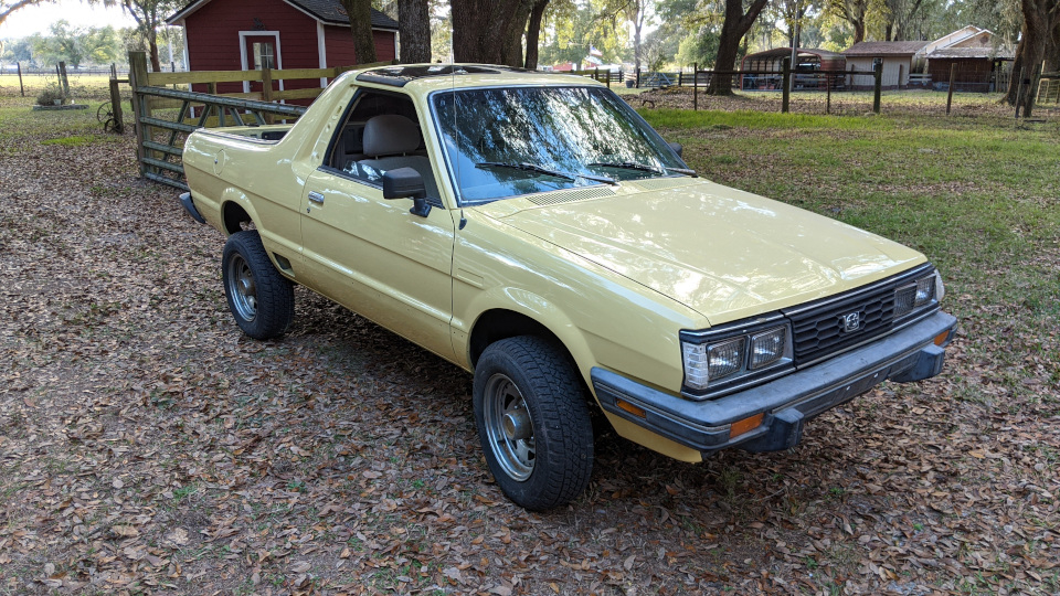

Mostly wanted to just update anybody interested on my 83 Brat project. I just got it painted and some of the trim back on. I originally wanted a tan cream color rather than the factory "Harvest Beige" but made a last minute impulse decision to go with more of a yellow/buttermilk color. It's kind of growing on me because it catches the eye,  isn't *too* flashy, and most folks think it might be a stock color. Obviously I am not restoring it to factory original, I'm going for a daily driver that will last a while. I completely and literally scrubbed the under body, hosed it down with Rust Mort, and them covered it with truck bed liner. The bottom lips on the rocker panels were pretty beat up so I welded some angle iron to strengthen them. There were a few serious rust issues on the body but I was able to deal with them and seal both sides of the metal so I think it will last a while. Oh, and it started out in life as an automatic but I put in a 4MT dual range. It just seems wrong to have an automatic Brat, and the original transmission had issues anyway. The previous owner was kind enough to rebuild the engine but the carburetor crapped out so I put on a weber. The plan is to tow it behind my RV, so if you see a buttermilk Brat rolling down the highway behind an RV it's probably me.

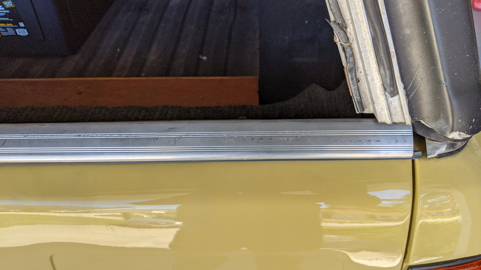

The next thing to do is to refurbish the bumpers and other exterior plastic trim, and I'm debating just cleaning them up good and clear coating them or else actually painting them black with the super duper SEM stuff. One big thing I am missing is the tail gate trim, and I'm going to use aluminum door threshold (M-D Building products low dome 49") as a base for that. I've also dug up some part numbers that I think would be useful in one place:

Using an aluminum threshold for tailgate trim is still looking promising but I'm not done yet. If you want to try it yourself first you have to trim the length about 3/8 inch (6 mm or so for our non US friends), then cut about an inch (25mm) from the width. The hard part is working the aluminum with minimal tools because it is strong and light but relatively brittle. I ran out of time last weekend, but I'm in the middle of making two 45 degree bends lengthwise in it with a 4 inch vise and a rubber mallet. Assuming it turns out well when I get it done I'll post some pictures.

Cutting down and bending an aluminum door threshold resulted in a pretty good solution for tailgate trim. I ended up inserting the standard (new) plastic bed trim clips for stability, but using the screws that came with threshold and drilling new holes into the tailgate. I'm pretty sure it will take some abuse and I think it looks pretty decent. I might beat on it some more to lower it a bit, but it's good enough for now.
