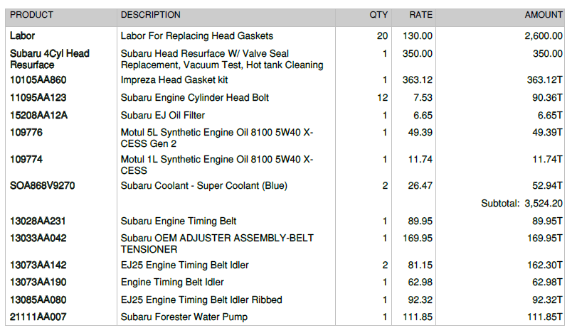

faunjoustino Posted January 10, 2022 Share Posted January 10, 2022 --- 1999 Subaru Legacy Outback 2.5L DOHC 4EAT AWD --- Hey all! In anticipation of a engine swap I was talking with my local shop that is insanely experienced and truly honest, fair and professional their name is Kaiju Motorsports here in Henderson, Near Las Vegas Nevada. Let me know if there any other shops out here so far this seems to be the top notch shop in Vegas. They quoted me about 17-25 hours @110/hr for a swap with a 2.2L or 2.5L, they said it would be that many hours due to all the inevitable issues that pop up with an engine swap like wiring and other mechanical hiccups. Is that a fair quote for guys who 100% know what they are doing? its not just swap and that's it they make sure it fully functional and kinks are worked out before the job is "done" also if I'm buying an engine what else is necessary to purchase? I imagine its not just buy 1 engine and that's it, I'm sure there will be new gaskets or wires or ecu i have no idea.. so what else am I looking for when "buying an engine" so I can price things out ahead of time. also let me know if swapping to an H6 ez30 is a better idea since i want to lift this thing 2 inches and make it a camper and i doubt that the 2.2 will make life very enjoyable loaded up with camping gear, they quoted about 25-35 hours for that. Link to comment Share on other sites More sharing options...

GeneralDisorder Posted January 12, 2022 Share Posted January 12, 2022 That's a mildly-high quote. And I fear they have no idea what they are talking about..... An EJ22E swap from a 1995 automatic takes no more time than pulling and installing the original engine. This is generally about 6 hours. If you also figure a complete reseal of said engine (good idea), then you can probably figure about 14 hours. Doing HG's on-up. A qualified tech can probably do this in half that. But we consider the worst possible scenario - heli-coil many threads, lots of cleaning and prep, etc...... 251 bottom end swap is similar - should be about 14-16 hours at MOST. Shops do quote high. Hell.... I know this better than anyone - people ask me for quotes on the most outlandish things you can imagine - we are really a high performance speed and tuning shop that does repair and maintenance to keep the lights on in the winter, etc. Many of my customers don't trust any other shop because I'm honest to a fault - I charge what is needed to pay my employees a proper living wage and keep my lights on. I'm also not in the repair market in your area of the country so it's really hard for me to determine an "honest" quote. GD 3 Link to comment Share on other sites More sharing options...

GeneralDisorder Posted January 14, 2022 Share Posted January 14, 2022 (edited) That shop doesn't know what they are talking about. So many flaws in that quote. High Points: You don't buy a head gasket "kit". You buy the parts individually - it's much cheaper. About $100 cheaper than their quote. Or more. And that's OEM Subaru retail pricing I'm talking about. Subaru only sells a complete gasket kit and those are not a good deal as they cover multiple engines and include many things you do not need and will not be using. Head bolts are NOT TTY and do not require replacement except on an individual basis if they are damaged or corroded (not typical). At least they got the pricing right. But they don't understand these engines. This engine does not use Super-Blue coolant and never did. That came 10 years later in 2009. And it eats plastic cooling system components. I would avoid it at all costs on vehicles not designed for it. It is NOT better than standard green. Subaru oil filters are junk - made by Honeywell/Fram (lowest bidder) for the USDM only. Even Subaru Japan will not allow their use on the newer engines. WIX is much better with an up-front bypass valve design. Amsoil is better yet although right now the EA15K12 filter is back-ordered due to production delays related to the short supply of steel to make filters. Valve stem seals are a good idea and resurfacing is absolutely required but they make no mention of the need (and it IS needed) to check and adjust the valve lash on the heads. Many of the shims are NLA from Subaru and this may require grinding the valve stems to adjust the lash, and also the shims are generally not in stock for the 25D - requiring often a 3-5 day wait to get these parts. They have too many hours for the head gasket replacement, and insufficient labor/parts for the cylinder head work. They have 6 liters of oil listed for an engine that takes 4.3 liters (4.5 quarts). There's likely more if I want to read between the lines but I've already started drinking and IMHO this shop is not qualified to work on this engine. GD Edited January 14, 2022 by GeneralDisorder 1 Link to comment Share on other sites More sharing options...

ThosL Posted January 14, 2022 Share Posted January 14, 2022 That's a lot of money for an old vehicle. I'd look at competitors in other towns or states, though the tow would cost. North of $4K for a top to bottom engine swap and rebuild is pretty extreme. If you did a thorough search for Subarus that would be as good as that one, and may be available for under $5K. Link to comment Share on other sites More sharing options...
heartless Posted January 14, 2022 Share Posted January 14, 2022 i am sitting here looking at the timing costs.. OMG is that WAY overpriced!!! the total of JUST the timing components is $689.35 - plus taxes... that is some serious raping there. a good Aisin timing kit is about 1/3rd that cost - just purchased one for our 2004 EJ251 at a cost of $244 & change - i would expect one for the EJ25D to be similar, possibly a little less and yes, this includes the water pump, all the idlers, etc.. and i have to agree on the EJ251 - with proper care, they are a good motor.. my 2002 Forester had one, as does the 2004... the 02 had similar mileage when I sold it and was still going strong. I personally have no experience with the EJ25D, based on info from this forum, i tend to avoid them, LOL 1 Link to comment Share on other sites More sharing options...
idosubaru Posted January 14, 2022 Share Posted January 14, 2022 7 hours ago, heartless said: i am sitting here looking at the timing costs.. OMG is that WAY overpriced!!! the total of JUST the timing components is $689.35 - plus taxes... that is some serious raping there. a good Aisin timing kit is about 1/3rd that cost - just purchased one for our 2004 EJ251 at a cost of $244 & change - i would expect one for the EJ25D to be similar, possibly a little less and yes, this includes the water pump, all the idlers, etc.. and i have to agree on the EJ251 - with proper care, they are a good motor.. my 2002 Forester had one, as does the 2004... the 02 had similar mileage when I sold it and was still going strong. I personally have no experience with the EJ25D, based on info from this forum, i tend to avoid them, LOL It's las vegas...I guess we should expect excess. lol I agree. At the same time, many shops have to have simple one size fits all solutions that are easily repeatable for the dozens of different vehicles/years/makes/models they see monthly. Imagine doing this for every quote, phone call or question on 50 different engines in a month. One size fits all solutions are typically wasteful but they are common place in almost of business. Lots of shops do this, or use aftermarket parts, or don't replace the ideal parts (just the t belt or belt and pump, etc) That's the norm. The surprise isn't those - but the shop that can dial it in for platform specific service on each engine type. That's where manufacturer specific service can be helpful. I agree with you but I don't necessarily call them evil or cheats. Their business (and maybe reputation) is apparently good enough, or Las Vegas crazy enough, the market allows them to do it. Link to comment Share on other sites More sharing options...

heartless Posted January 17, 2022 Share Posted January 17, 2022 4 hours ago, idosubaru said: Oh right on. I know you get it. I was thinking about the op, didn’t want op to think the shop is completely off base or dishonest. about the only thing I think the shop is way off base on is the labor hours.. I also realize that most shops have a "shop time" listing that is used to estimate pricing.. but i still think the 20hrs is excessive. and yeah, go look up prices for the parts, even at the Subaru discount places, and the prices are not that far off when looking at individual parts - thus the reason for the Aisin kits.. a third of the cost, and quality parts. I am lucky enough to have a decent shop near me that is reputable, and i trust enough, to take my car to when I am unable to do things for various reasons.. stuff like wheel bearings (dont have the equipment), alignments, etc.. And they have no issue with me bringing in parts that I have sourced myself. 1 Link to comment Share on other sites More sharing options...
