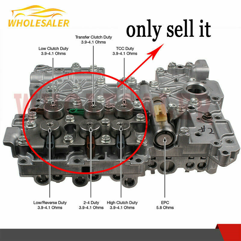

sirtokesalot Posted February 24, 2022 Author Share Posted February 24, 2022 so this is the solenoid setup the transmission has in it. and im suspecting the transfer clutch duty solenoid is the one i need to replace. are the other solenoids the same thing? could i swap 2 of them around to see if the issue moves with the solenoid to another part of the transmission? basically i want to find out if the solenoid is truely bad or not before tossing 100 bucks worth of solenoids in it. id like to swap 2 of them re assemble it and find out if it still binds or not. Quote Link to comment Share on other sites More sharing options...

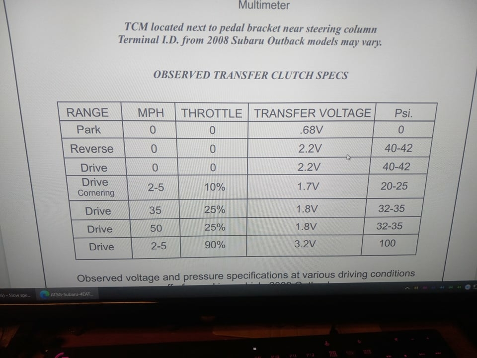

sirtokesalot Posted February 24, 2022 Author Share Posted February 24, 2022 (edited) basing my findings off this picture i found in a pdf about torque bind in the 05-09 subarus i believe the solenoid is bad even though it activates fwd.the voltages seem in spec everywhere except drive cornering 2-5mph where it stays around 2.2v but this is without giving it gas. when i start to give it gas the voltage does go down some. i dunno really. Edited February 24, 2022 by sirtokesalot Quote Link to comment Share on other sites More sharing options...

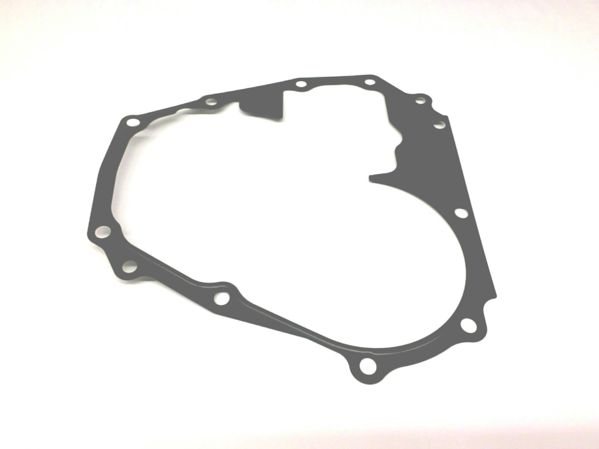

sirtokesalot Posted March 2, 2022 Author Share Posted March 2, 2022 can the metal gasket for the tail housing on the transmission be re used? Quote Link to comment Share on other sites More sharing options...
