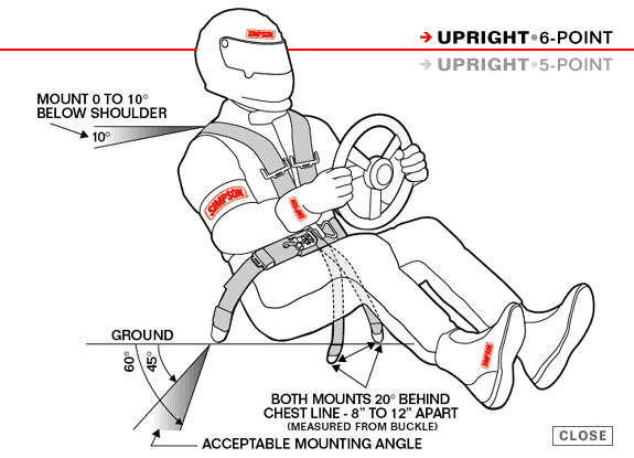

garner Posted July 15, 2004 Share Posted July 15, 2004 and for my 3 point harness how should i install the shoulder ones....? verticle ... horizontal... top or bottom of bar?? - Brandon Brandon, here's a pic of mounting a 5 or 6 point harness. The shoulder straps are critical. If they are too low, and you have a major front impact, you'll compress your spine and well, thats not good. Don't turn a safety sevice into a weapon. good luck Link to comment Share on other sites More sharing options...
