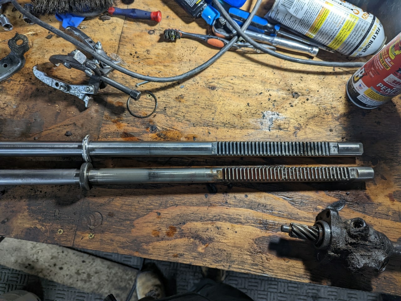

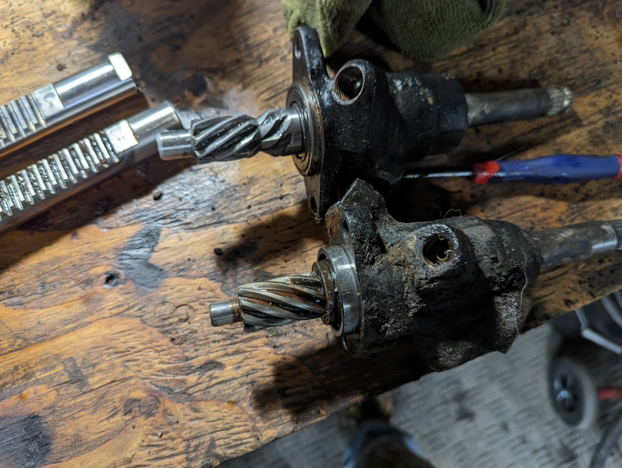

PostalLeggy Posted April 23, 2022 Author Share Posted April 23, 2022 4 hours ago, idosubaru said: That's a good idea for acquiring less warn parts. Can the rack housing get scored and need finished as well? Here's the only two Subaru rebuilds I'm aware of that exist - the first one is your exact steering rack. I have it saved because XT6 steering racks are also NLA although we do have non-XT6 options that will work which you don't have: https://bbs.legacycentral.org/viewtopic.php?f=6&t=45717 https://drive.google.com/file/d/1nlnYUjx_TvJvtbzorMoIWHBv24T7WUMi/view Looking at those writeups, I honestly feel like I might be able to swap internals like I am thinking. I can sort of picture those parts just working in either orientation. Quote Link to comment Share on other sites More sharing options...
idosubaru Posted April 23, 2022 Share Posted April 23, 2022 9 hours ago, PostalLeggy said: Looking at those writeups, I honestly feel like I might be able to swap internals like I am thinking. I can sort of picture those parts just working in either orientation. Yep good thinking to try it. Most of the parts look symmetric such that left or right doesn’t matter. I guess the seals are available? It’s usually not recommended to use seals once they’ve been installed. Quote Link to comment Share on other sites More sharing options...
PostalLeggy Posted April 24, 2022 Author Share Posted April 24, 2022 19 hours ago, idosubaru said: Yep good thinking to try it. Most of the parts look symmetric such that left or right doesn’t matter. I guess the seals are available? It’s usually not recommended to use seals once they’ve been installed. I bought a seal kit and as far as I know all the seals are the same. Guess we will find out soon, as I just picked up a LHD rack from the junkyard today. Gonna start tearing into it soon and get some experience taking one apart before I dive into the unreplaceable one that my entire job currently depends on... No pressure. Quote Link to comment Share on other sites More sharing options...

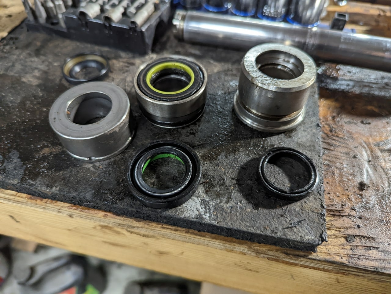

PostalLeggy Posted April 26, 2022 Author Share Posted April 26, 2022 (edited) 19 hours ago, el_freddo said: And “Wait Awhile” Western Australia is a BIG place! @PostalLeggy - the Gen1 was quite popular here. We just don’t see them that often in the parts yards anymore, they’ve had their peak time already but aren’t yet “rare” enough for one to be stripped out the day after it lands in the parts yard. So the few examples you see will sit there for sometime until they’re turned over due to time in the yard. I hope the LHD parts can be used in the RHD rack to solve the issues you’re having or trying to resolve! Cheers Bennie Unfortunately the parts are all different between the two racks... right down to the point where the reseal kit I purchased won't work on my rack. I'm now in a bit of a predicament as I have work in 4 days and a rack that is completely torn down with no way of me resealing it. Attached are some photos that show the difference between these racks. I'm not sure if I can even buy a reseal kit for it, or if it's something I would need to import. Even the Teflon seals are a different width. Edited April 26, 2022 by PostalLeggy Quote Link to comment Share on other sites More sharing options...
el_freddo Posted April 26, 2022 Share Posted April 26, 2022 Oh wow, I didn’t expect the seals to be completely different! I hope you manage to get something back together to get you going again. You’re still using a Gen1 on the postal route? What about shipping a RHD Liberty wagon from Oz? Crazy idea I know but it’s newer and RHD that you seem to need. Just the $$$$s are the killer in this economic climate! Cheers Bennie Quote Link to comment Share on other sites More sharing options...
PostalLeggy Posted April 26, 2022 Author Share Posted April 26, 2022 1 minute ago, el_freddo said: Oh wow, I didn’t expect the seals to be completely different! I hope you manage to get something back together to get you going again. You’re still using a Gen1 on the postal route? What about shipping a RHD Liberty wagon from Oz? Crazy idea I know but it’s newer and RHD that you seem to need. Just the $$$$s are the killer in this economic climate! Cheers Bennie Importing stuff is always an option but as you said it's just the dollarydoos. Our import laws only let us bring in vehicles that are 25 years and older, so a 1997 is the newest vehicle that could be imported. A lot of mail carriers do that, in fact. I work with someone who is in a Japanese land cruiser. The gen 1 I have is sort of special because it was built for the USDM and has spent it's entire life here in the states delivering mail. I already have a lot of money sank into the legacy so it's sort of a sunk cost situation with me wanting to get it squared away. Gonna see if I can find out what the heck this rack is and get me some seals for it, if not importing a rack might be my only other option. 1 Quote Link to comment Share on other sites More sharing options...
