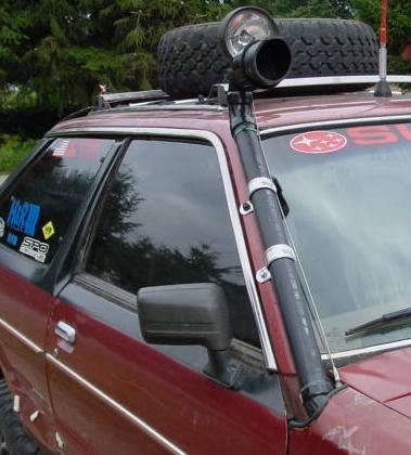

I do believe the inside snorkel could work, in an open top jeep perhaps. Not so much on a closed cabin subaru though. 2" PVC and a hole in the fender should do it. Might have to relocate the vacuum canister though thats near the fender (or where it might get cut).
Oh and attached is Qmans Snorkel pic.
