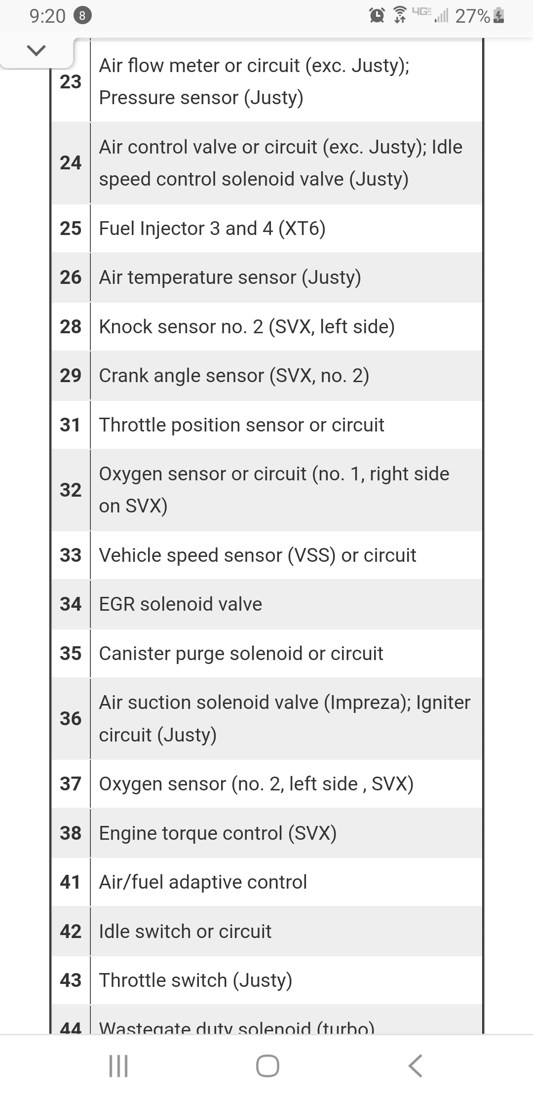

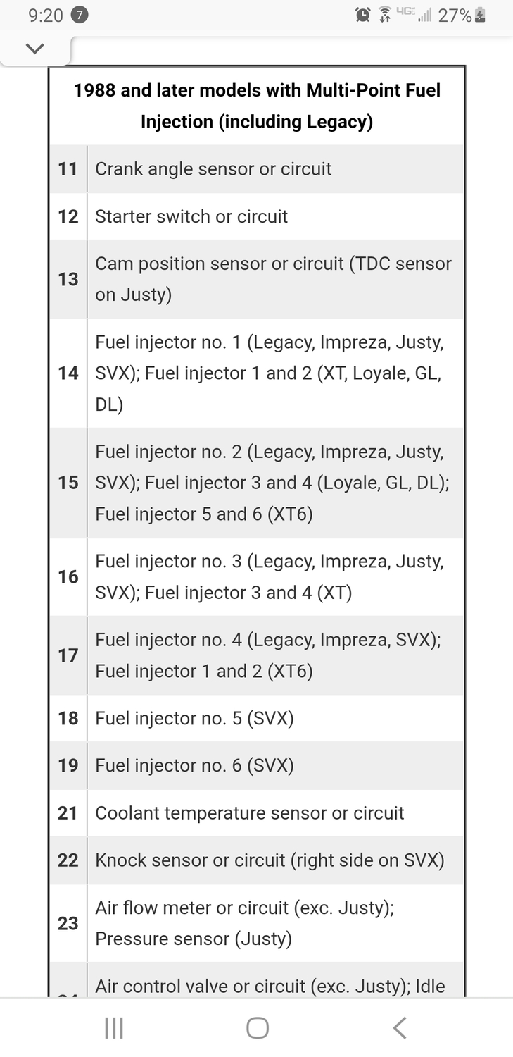

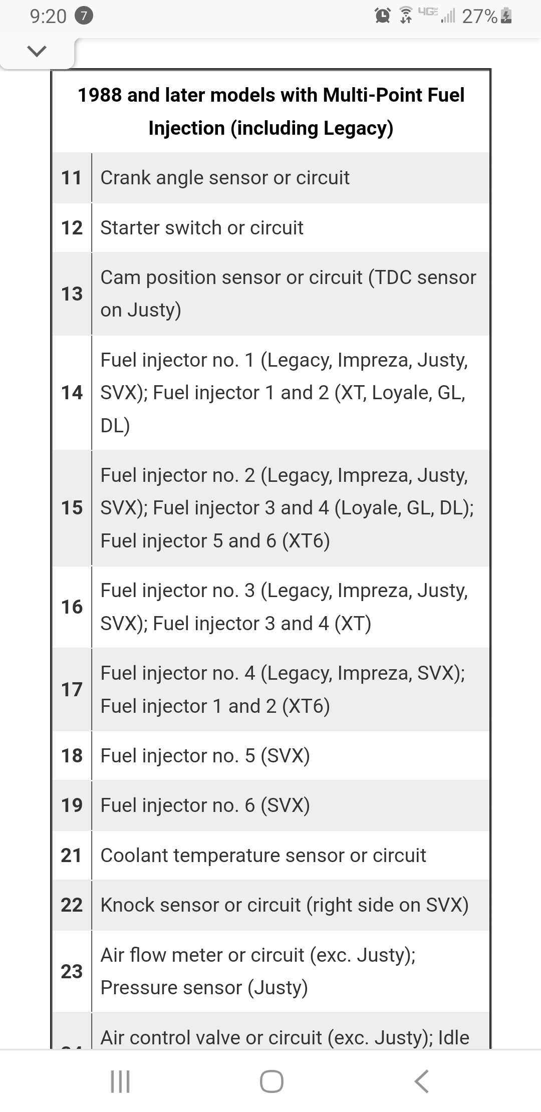

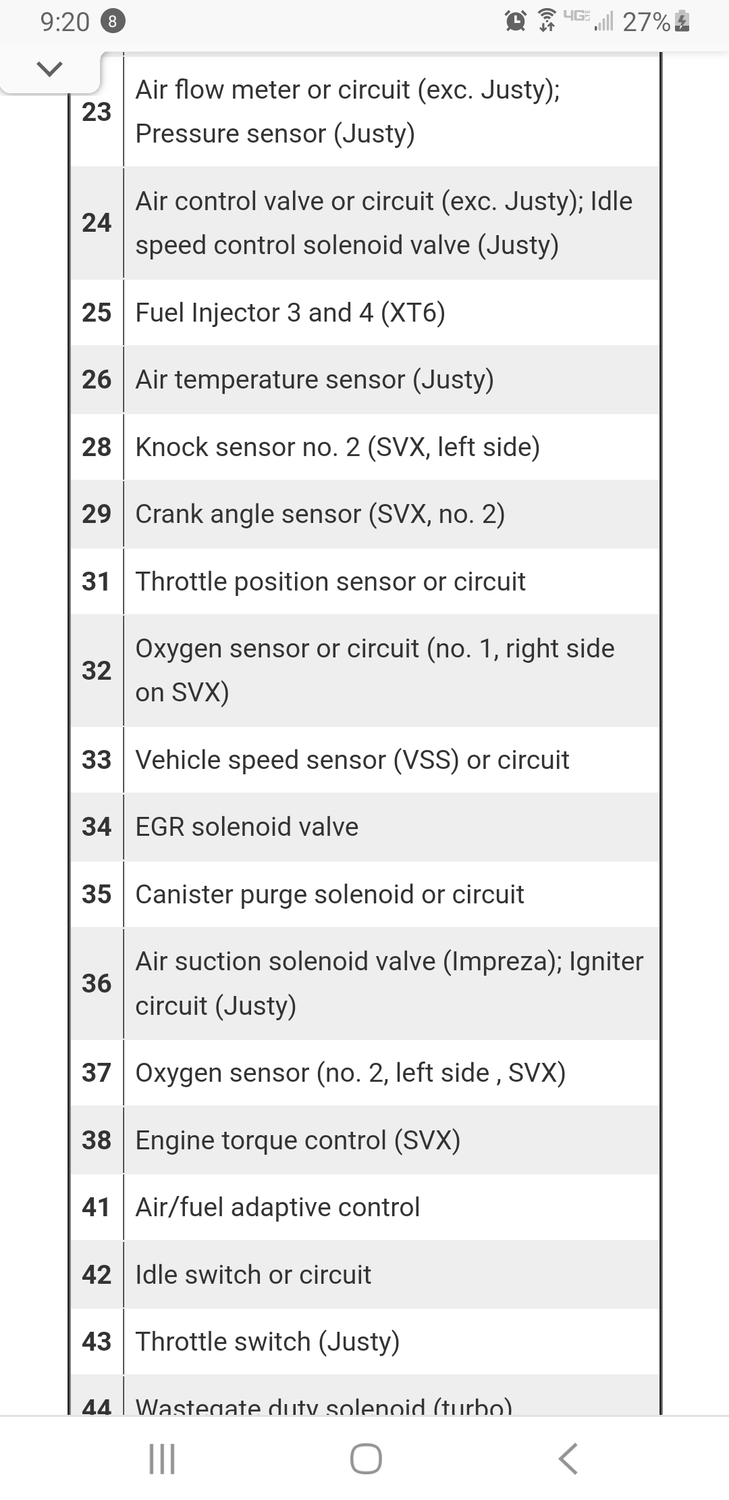

Btcox Posted June 14, 2022 Author Share Posted June 14, 2022 Update: By looking at the codes, there is no code for an ignition (ignitor) control module for the impreza so this could explain no CEL. Its a pricey part but I've ordered a replacement and should arrive Thursday. I'll be back with an update after install and test. Quote Link to comment Share on other sites More sharing options...
