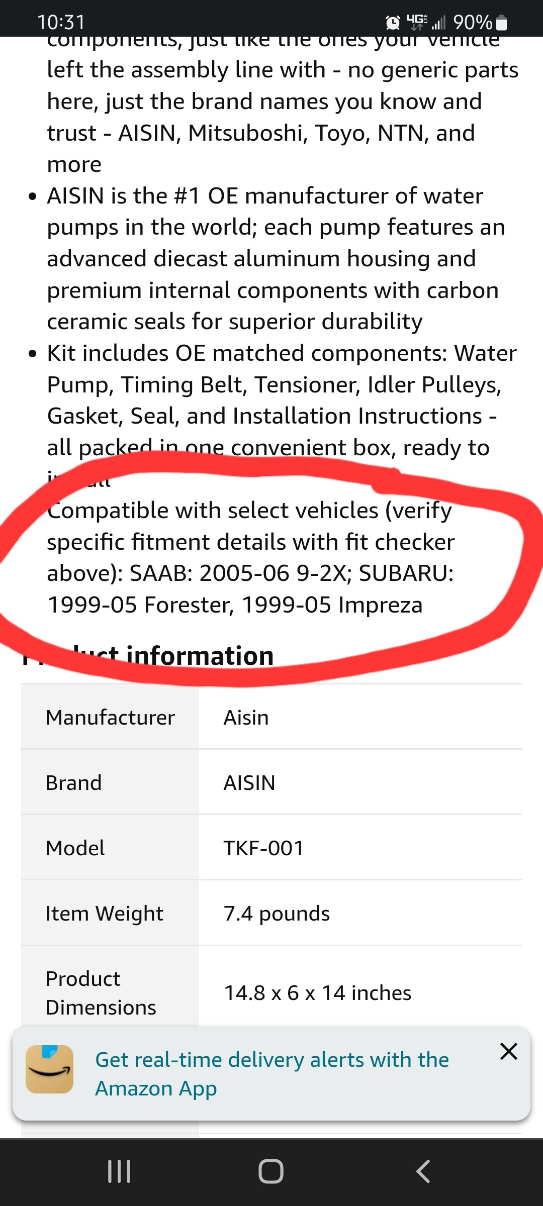

punx2400 Posted May 17, 2022 Author Share Posted May 17, 2022 2 hours ago, idosubaru said: Search for the AISIN part number: TKF-001 https://www.rockauto.com/en/parts/aisin,TKF001,timing+belt%2C+water+pump+&+component+kit,16088 See, this is what I thought too! But.. Looking at this pic I just screenshotted, no mention of outback, or legacy for that matter. But if you're sure, I'll take your word for it. Quote Link to comment Share on other sites More sharing options...

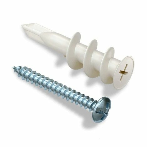

jonathan909 Posted May 17, 2022 Share Posted May 17, 2022 (edited) I feel you. Completely understandable to go the extra kilometer and get that baseline peace of mind. Today's fastener coincidence: I'm in the middle of some lightweight front end bodywork on my girls' '05 Mustang ragtop - they clipped a deer last fall, so we're replacing bumper cover, a fender, and a couple of lights. In another case of what-fscking-slob-had-his-mitts-on-this, we found ample evidence of a previous front-end "event", and where there should be a metal plate with three captive studs that anchors the fender, bumper cover, and turn signal together, the old, rusted-out original plates were used, but held together with - wait for it... those big screw-in drywall anchors. And wire ties. Lots of wire ties. Sheeeeeeeee-it. Edited May 17, 2022 by jonathan909 Quote Link to comment Share on other sites More sharing options...
jonathan909 Posted May 17, 2022 Share Posted May 17, 2022 (edited) 11 minutes ago, punx2400 said: See, this is what I thought too! But.. Looking at this pic I just screenshotted, no mention of outback, or legacy for that matter. But if you're sure, I'll take your word for it. That's just goofy - the EJ25 used in those cars is the same as that in the Legacy/Outback. Maybe they didn't list those cars because they had other engine options e.g. DOHC, H6, etc., which it obviously wouldn't be compatible with. But if yours is a SOHC it should be the right one. Edited May 17, 2022 by jonathan909 Quote Link to comment Share on other sites More sharing options...
punx2400 Posted May 17, 2022 Author Share Posted May 17, 2022 1 hour ago, jonathan909 said: I feel you. Completely understandable to go the extra kilometer and get that baseline peace of mind. Today's fastener coincidence: I'm in the middle of some lightweight front end bodywork on my girls' '05 Mustang ragtop - they clipped a deer last fall, so we're replacing bumper cover, a fender, and a couple of lights. In another case of what-fscking-slob-had-his-mitts-on-this, we found ample evidence of a previous front-end "event", and where there should be a metal plate with three captive studs that anchors the fender, bumper cover, and turn signal together, the old, rusted-out original plates were used, but held together with - wait for it... those big screw-in drywall anchors. And wire ties. Lots of wire ties. Sheeeeeeeee-it. Tell me you don't mean toggle bolts... Holy spoob. Lol Quote Link to comment Share on other sites More sharing options...
punx2400 Posted May 17, 2022 Author Share Posted May 17, 2022 1 hour ago, jonathan909 said: That's just goofy - the EJ25 used in those cars is the same as that in the Legacy/Outback. Maybe they didn't list those cars because they had other engine options e.g. DOHC, H6, etc., which it obviously wouldn't be compatible with. But if yours is a SOHC it should be the right one. OK, thank you sir! Quote Link to comment Share on other sites More sharing options...
idosubaru Posted May 17, 2022 Share Posted May 17, 2022 9 hours ago, punx2400 said: Just bought a 2003 outback a couple days ago and am freshening up most parts for peace of mind. Right now I'm stuck on the timing belt/waterpump/pulley kit. Shopping around, I see gates, continental and ac Delco. Reading up, I see aisin is actually the way to go, but I can't pin down which kit is right, as product descriptions are vague or misleading. Helpful hints:4th VIN letter 'B', t-stat at bottom - if that helps When there’s confusion check with manufacturer. AISIN says: TKF010 https://aisinaftermarket.com/english/onlineparts.html 1 Quote Link to comment Share on other sites More sharing options...

jonathan909 Posted May 17, 2022 Share Posted May 17, 2022 4 hours ago, punx2400 said: Tell me you don't mean toggle bolts... Holy spoob. Lol No, these ones. On the plus side, at least the two parts didn't rust together! Quote Link to comment Share on other sites More sharing options...
punx2400 Posted May 18, 2022 Author Share Posted May 18, 2022 9 hours ago, jonathan909 said: No, these ones. On the plus side, at least the two parts didn't rust together! Oh, for Fuchs sake. 1 Quote Link to comment Share on other sites More sharing options...
punx2400 Posted May 18, 2022 Author Share Posted May 18, 2022 13 hours ago, idosubaru said: When there’s confusion check with manufacturer. AISIN says: TKF010 https://aisinaftermarket.com/english/onlineparts.html I don't know why I didn't see the vehicle application to this part number before on Amazon. It's literally right there. Haha thanks buddy 1 Quote Link to comment Share on other sites More sharing options...

idosubaru Posted May 18, 2022 Share Posted May 18, 2022 9 hours ago, punx2400 said: I don't know why I didn't see the vehicle application to this part number before on Amazon. It's literally right there. Haha thanks buddy You're welcome. It's confusing. AISIN kit designations have changed over time while listings through 3rd party suppliers and internet searches haven't tracked those changes very well. Quote Link to comment Share on other sites More sharing options...
