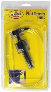

1 Lucky Texan Posted September 13, 2022 Share Posted September 13, 2022 loosen the fill plug on the rear BEFORE the drain. I used a floor jack on the handle of a 1/2" breaker bar. some gear lube comes in squeeze bags now but, when I did the rear, I used a pump kinda like this; Link to comment Share on other sites More sharing options...

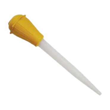

forester2002s Posted September 13, 2022 Share Posted September 13, 2022 Not what was asked, but here's a useful tool for oil-filling: You can often find a Turkey Baster at low-cost at dollar-stores. Useful for filling or topping-up of rear-differentials. And can help with adding oil down the dipstick-tube of some manual transmissions. 2 Link to comment Share on other sites More sharing options...
