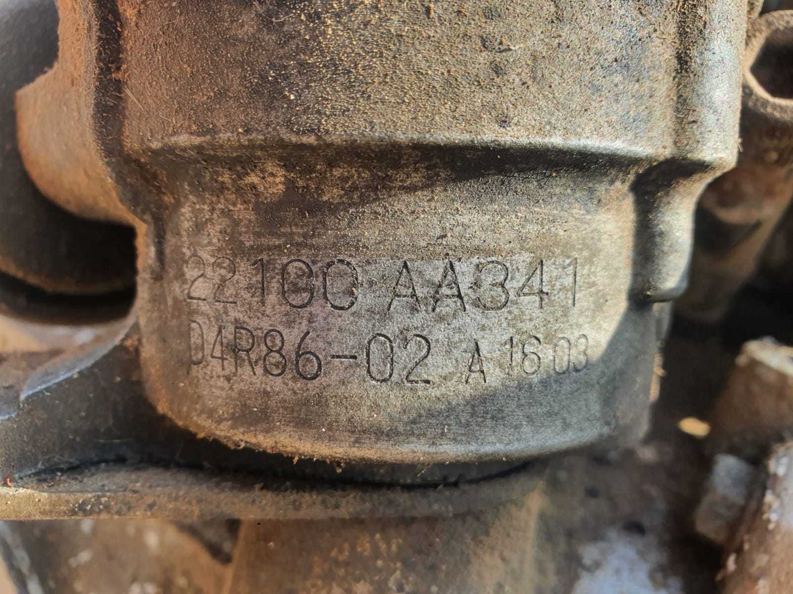

Mayanstolero Posted September 17, 2022 Share Posted September 17, 2022 hey guys, can you please help me to identify what type of disti to i have? i took a picture of the part number. and where can i find spare parts for it? Link to comment Share on other sites More sharing options...
Steptoe's photos Posted September 18, 2022 Share Posted September 18, 2022 before I looked in, I could see myself saying that a part number stamped into the side is often the most helpful OK. I don't recognise that number at the moment. Is it a points dizzy, or module? Do you have any inkling as to what engine series it looks like it will fit - your close up does not pan out to see if it is EA81 or earlier, or even EA82 twin ear Distributors with part number 22100AA341 stock | ProxyParts.com this link says year model 1990 1.8 litre petrol for Legacy Link to comment Share on other sites More sharing options...
Steptoe's photos Posted September 18, 2022 Share Posted September 18, 2022 Aaand... you can't believe everything you read/find on the internet. This part number sounded like EA82 body series stuff so I looked it up in L Series catalogue and now note your location. The parts manual says it is for 1.6 litre 1988 through to 1992, maybe 1987 as well (don't recall exactly) So, EA71 engine in an L Series (GEN2) body What are you doing ?? Link to comment Share on other sites More sharing options...
GeneralDisorder Posted September 18, 2022 Share Posted September 18, 2022 No clue on that one. Need pics of the insides and even then..... Israel got Brat's till like 1994 so it could be some weird thing that the rest of the world never saw. Probably similar to other ND or Hitachi electronic distributors though. GD Link to comment Share on other sites More sharing options...
el_freddo Posted September 18, 2022 Share Posted September 18, 2022 I’m going to say it’s off an EA82 style engine since there’s a heater hose outlet to the right in the background. AFAIK EA71 still has the dizzy on the front of the engine like the EA81, so I’d rule that out. That’s my 5c guess. Cheers Bennie Link to comment Share on other sites More sharing options...
Mayanstolero Posted September 18, 2022 Author Share Posted September 18, 2022 hey guys, thx for the answers. this is an ea71 engine and the disti is a non contact type. i find it really hard to get it set up, i think it might have some bad parts inside. Link to comment Share on other sites More sharing options...
Steptoe's photos Posted September 20, 2022 Share Posted September 20, 2022 Well, not holding you to ransom but pretty sure others would also like to know/see some detail of what this EA71 is in - to grab attention perhaps , of others that may be able to walk you through set up steps. At this stage we don't know what you have it in , if you have any or much mechanical ability, or even a manual to get you past all the easy stuff. Some with EA71 contact points distributors might also crave a distributor with a module inside. With these Hitachi distributors of EA81 and EA82 (1984 only I think) the usual replacement parts are rotor button and distributor cap, then ignition module and the vacuum advance canister on the side. Rarely, some need the bushing replaced. I suspect the module in yours of unknown year at the moment, will be the same module of EA81 and EA82. If so, still easy to get. They are also common to Honda and possibly Nissan of the same era. Vacuum canisters can be overhauled. I can get some factory part numbers to suit this distributor to aid chasing parts Link to comment Share on other sites More sharing options...
el_freddo Posted September 21, 2022 Share Posted September 21, 2022 EA71 posted in an 80’s forum I reckon this could be in an L series @Steptoe's photos, they came like this from factory in some parts of the world like Africa! But I’m keen to now what it’s in too. As Steptoe said @Mayanstolero, it could be the ignition module in the dizzy that’s died. This is replaceable - I’d also recommend replacing your coil too as these kill ignition modules if they’re not operating properly or when they die. Cheers Bennie Link to comment Share on other sites More sharing options...
