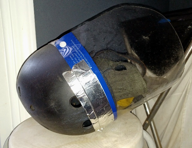

nvu Posted October 31, 2022 Share Posted October 31, 2022 10 minutes ago, jonathan909 said: Please choose between not being able to see because dirt's falling in your eyes or not being able to see because the visor's fogged. Fun^2. For extra fun, those covid worker face shields were like $5 for a 15 pack at local swapmeet. Taped one to a helmet and it's been ghetto fabulous. Skater helmets are designed to be really comfortable for lying on concrete; the default position of many new skaters. 1 4 Link to comment Share on other sites More sharing options...
