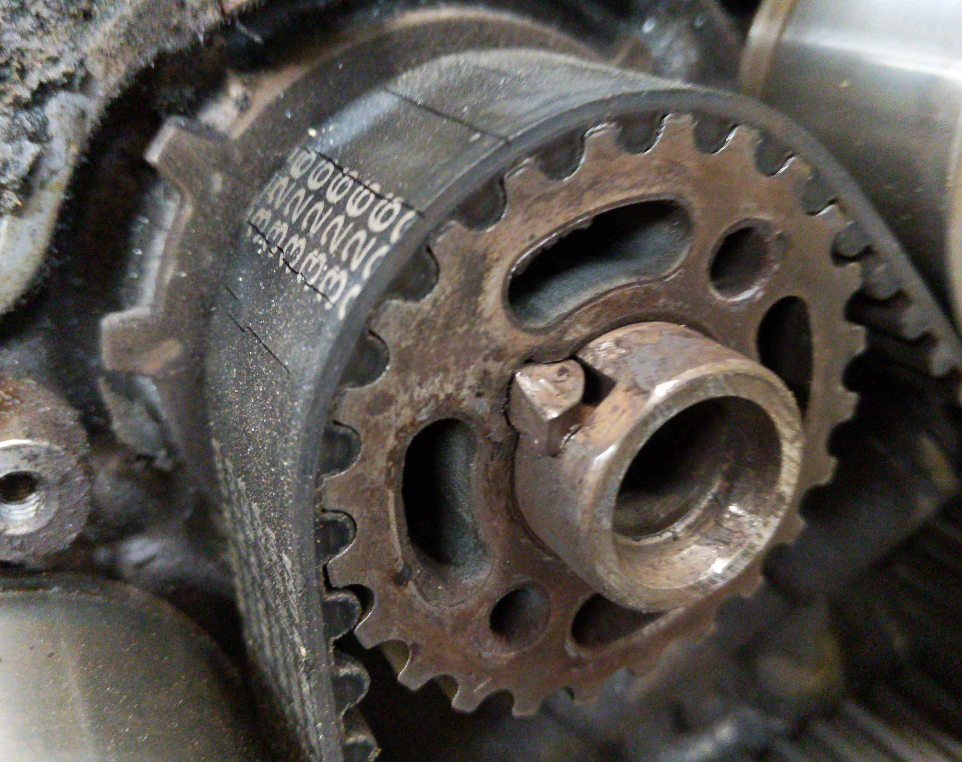

nelstomlinson Posted January 1, 2023 Author Share Posted January 1, 2023 The crank nose pulley and harmonic balancer are both pretty well ruined. The pic shows the crank nose pulley, with the woodruff key turned sideways. The key is chewed up, and it wallered out the keyways in the crank, pulley and balancer. Where do I find a new pulley? What part name or number do I search for? Link to comment Share on other sites More sharing options...
1 Lucky Texan Posted January 1, 2023 Share Posted January 1, 2023 maybe crank sprocket? becareful not to damage the tabs in the back - they are needed for the position sensor. I bet @GeneralDisorder or others can better advise you how to proceed. Link to comment Share on other sites More sharing options...

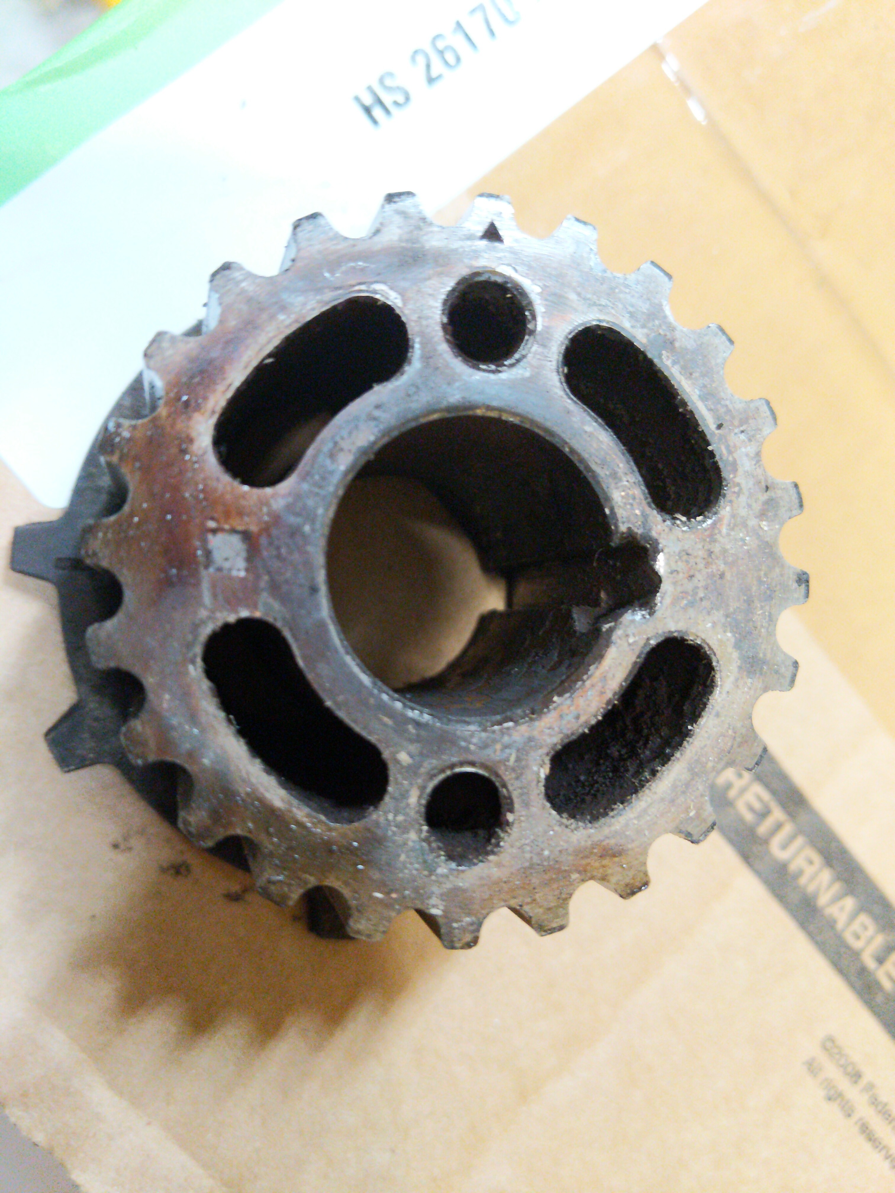

nelstomlinson Posted January 1, 2023 Author Share Posted January 1, 2023 The tabs on the back are the least of the worries, that damaged keyway is way beyond usable. Don't know if it's clear in this pic, but the keyway is wallered out to the point that it will slop enough to feel on the new crank nose. I think maybe the damage was caused by the crank nose bolt being loose? Link to comment Share on other sites More sharing options...
nelstomlinson Posted January 1, 2023 Author Share Posted January 1, 2023 I might have answered my own question: the manual calls it a crankshaft sprocket, and searching Subaru, I came up with a part number of 13021AA16A. Looked up that part number on fleabay and saw 24 teeth and the right timing tabs on the back: six tabs, symmetric but unevenly spaced. Link to comment Share on other sites More sharing options...
nvu Posted January 1, 2023 Share Posted January 1, 2023 56 minutes ago, nelstomlinson said: I think maybe the damage was caused by the crank nose bolt being loose? Yes, exactly because it was loose. Tighten to 133ft-lb, treat the procedure like headbolts. Oil up the bolt, clean out crankcase threads, try to torque in big 60 degree sweeps and avoid creaking. 1 Link to comment Share on other sites More sharing options...
