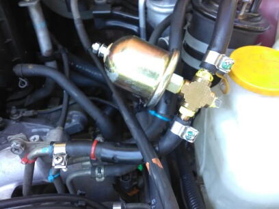

Steptoe's photos Posted March 20, 2023 Author Share Posted March 20, 2023 It is getting worse..... the test drive watching fuel pressure gauge at just under 40 psi and the momentary yet repeating stumble / cut out happens without any change to the fuel pressure. No need to pull fuel pump or FPR I cleaned up both battery terminal clamps, radiator earth, #3 intake runner earth with wire brush and electrical contact cleaner spray. ie ECU disconnected, so anything it learned in past 2000 km has been forgotten. Start up results in CEL 40 seconds later, rough idle, stumbles, misses, almost undriveable on flat ground into shed Next is to see if the CEL is gonna flash some codes when I join the diagnostic connectors. EA82 conversion coming up ! Link to comment Share on other sites More sharing options...

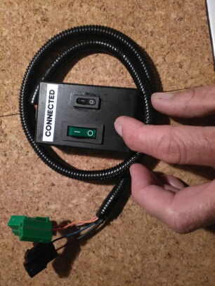

Steptoe's photos Posted March 23, 2023 Author Share Posted March 23, 2023 Yes, thinking a timing light may now throw some light on things. I might start swapping components from a donor wreck to this thing , one at a time. But first, I made this to allow self to be in upright position to observe what happens in the cockpit as the green and blacks are connected etc I found what the manual calls diagnostic earth terminals in at the test plugs. On mine, they were exposed as male terminals. On the seemingly untouched donor, they were still wrapped in factory loom wrap vinyl tape. Link to comment Share on other sites More sharing options...
