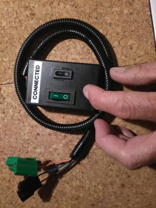

Steptoe's photos Posted April 7, 2023 Author Share Posted April 7, 2023 I am thinking I may just have to check my work around timing belts done only 2,000km ago - if I were to chase random stuff. Done enough of that already I think. What I cannot fathom is all I do is clean up a ground, and I get a new issue on next restart (attempt) . I do like my diagnostic plug switch box - made life easier, so next job is to make a relay can checker box to plug those ultra reliable Mitsu 22A relays into Link to comment Share on other sites More sharing options...
