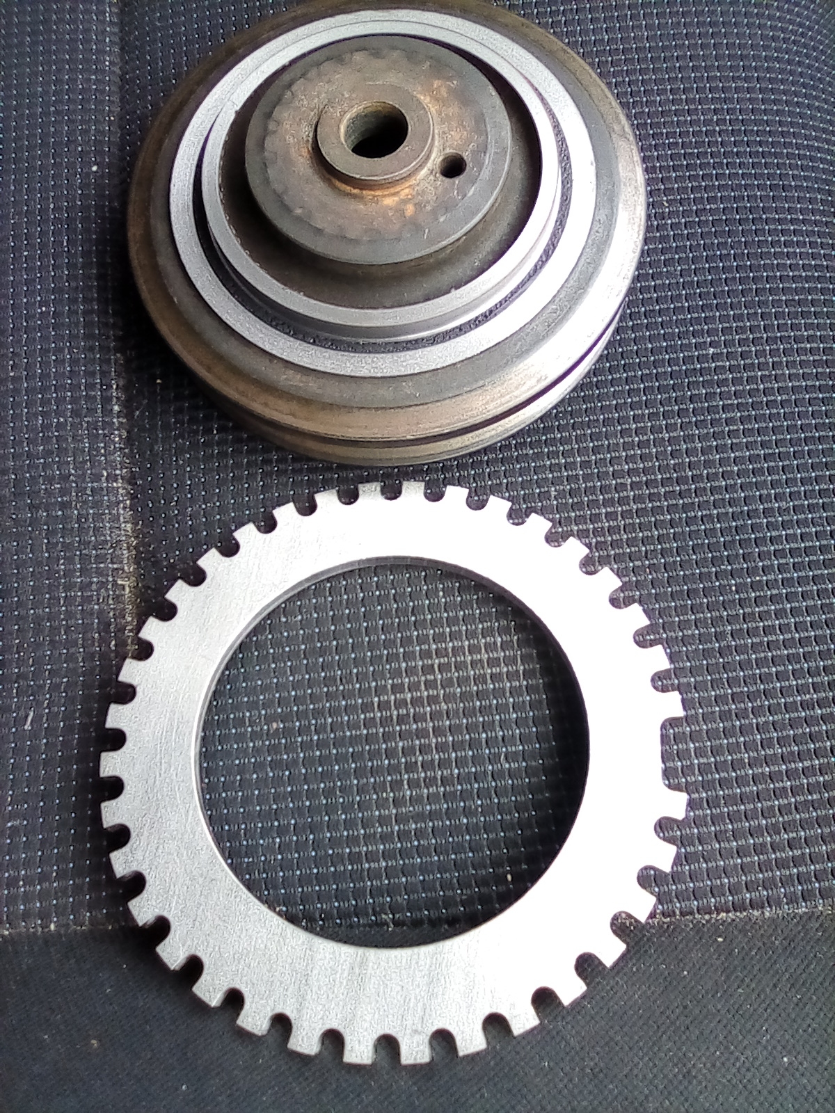

Step-a-toe Posted November 17, 2021 Share Posted November 17, 2021 Yep, but the dizzy you mention is not gonna work for me with my stuff and I am chasing crank fire accuracy if that is all possible. The dizzy of the series 1 with the 4 pin internal module (2 for ignition, two for knock control delay) also has roller bearings not the bushes of EA81 style dizzy. I have just put the hacksaw through the rear-most side of the rear V of the pulley. Through 5mm metal, 5 mm of rubber. Hacksaw to reduce chance of lathe work softening the rubber cushion to a point that it does not want to play any more. Next will be some lathe work to tidy up a support for the trigger wheel, and get trigger wheel ID cut to suit the pulley Link to comment Share on other sites More sharing options...
Steptoe's photos Posted November 27, 2021 Share Posted November 27, 2021 The 2V crank harmonic balancer got a trim down and trigger wheel's generic 36 minus 1 wheel got it's 1/2" hole enlarged so it now resembles a ring gear Link to comment Share on other sites More sharing options...

Steptoe's photos Posted November 29, 2021 Share Posted November 29, 2021 On 11/29/2021 at 4:50 AM, oddcomp said: Someone rang? Expand I have a few questions given that your work has inspired me to try EDIS4 and MJE. Meanwhile, I figured to do the above - ring gear will be solid mounted to inner section not the bit that can move on a rubber cushion, either move position or alter sensor gap at the worst moment. I think pics of yours vanished. You also did cam sensor? What happened to yours? Got any record of map advance bins? I am propane only and want to see more advance down low, limit upper revs advance and generally do something different to the dinosaur given the ignition modules are like hens teeth, and like 35 year old decay on them if found at a premium price Link to comment Share on other sites More sharing options...
