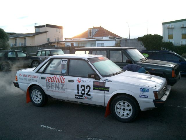

Hey all
this is my car the morning before the start of Rally Rotorua...looking nice and clean...

Setup
As you will see in the photo, I run the car with the front 1.5cm - 2cm higher than the rear, this stops the rear becoming light underbraking,

photo is taken at about 7am on a very cold morning in mid winter, outside a hotel in Rotorua. the car had ben outside all night, and I have only jsut started it up to warm it up before we left at 8ish. I think it was about -1 degrees c so it was a little cold...
