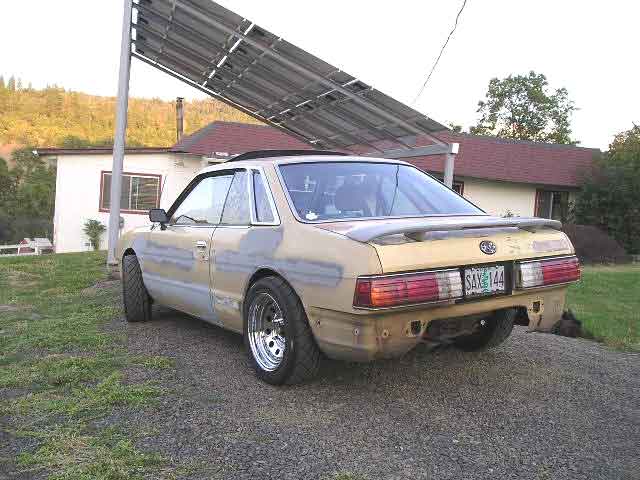

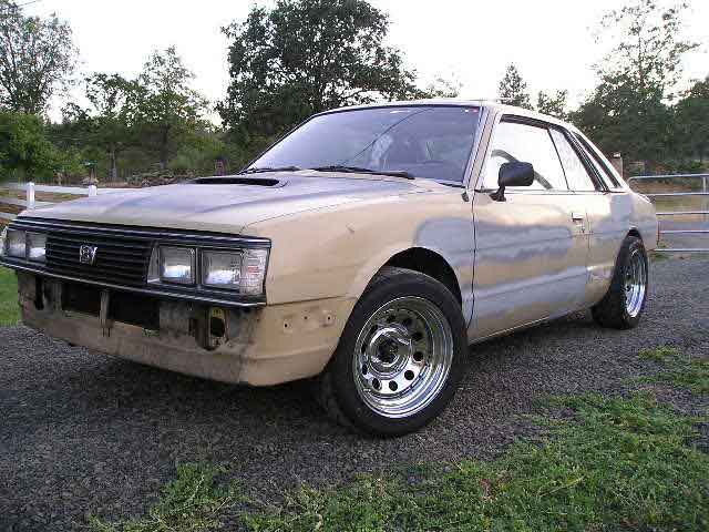

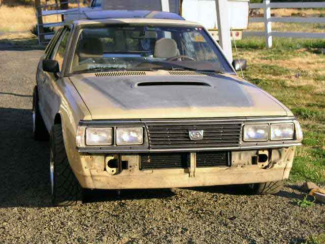

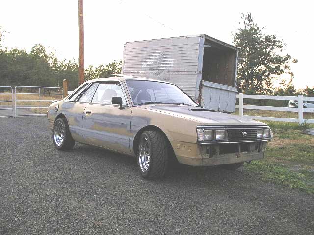

subusolo2nut Posted July 30, 2004 Share Posted July 30, 2004 OK-I've been real busy lately & haven't posted much of anything---Work-Ranch & Racing have taken 98% of the time I have---Still--T-Rex has been having a GREAT Autocross season--All Seconds & Thirds--still can't seem to pull that first place down :-\ but I'll keep doin' the mods & try harder-- Last mods- 1. Rear seat area is now plated with .032 6061 T6 aluminum--really stiffened the back of the car up. 2. Rear Sway bar from a early 90's Acura Intergra--I'll post pics if anyone is interested-worked real well in the back--was a easy mod--REALLY helped. 3. Falken Azisus Rs 205/50/15 tires on 4 x 130 0 offset rims--VW superbeatle rims--widened the track 2"-- also made the car look kind'a like the old Hot Wheels cars---have 6" ground clear with them--- I am still going to do the flairs & front/rear caps--just doing the things to lower the track times first-- Last event I was 4 sec faster that the Mini Coopers & BEAT a '02 WRX by 2 sec!! Not bad for a 22 yr old Gen 2 car!!! Link to comment Share on other sites More sharing options...

subusolo2nut Posted July 30, 2004 Author Share Posted July 30, 2004 I'd love to go to WCSS---but, my niece is having a wedding in Idaho Aug 22 & the next autocross is the next weekend (28/29th)---family before fun--you know. I'd invite you out to the autocross--lots of fun machinery going as fast as possible---- I will put it into my calandar for next year--should have the car much better along by then-- As to the VW mod--I welded up the stud holes in the front hubs & centered them in a lathe--had to reduce the centering lugs down to 100mm & set a scribe mark at 130mm--Centered all four new stud holes & drilled them. The rear drums were much easier--just offset the new holes 45deg from the old ones--scribed & drilled--used a endmill & straightened a area around the new stud holes--then installed all the new studs with blue Locktight (used late 70's chev 1/2 RH studs to make the lugnuts easy). The car is a 2WD 5 speed--Weight as raced without me is 1970LB--Engine is in the 100/105 HP range--40mm side-draft Dellorto on custom manifold (see the old FRANKINTAKE post)--dual 2" pipes back to a dual in/dual out Dynomax muffler with a "H" pipe at the diff & two 12" glaspacks staggered after to balance the tone--no power below 2000rpm--will rev real free up to 6500rpm---will hit 56mph at redline in second--- Link to comment Share on other sites More sharing options...

subusolo2nut Posted July 30, 2004 Author Share Posted July 30, 2004 WAY cool!! Could use some exterior work (paint etc.), when you finish with mechanical work. IF you finish with mechanical work!!! Wellll---My friend Brian was down the last event with his 300hp STi & I was 6sec behind him-----but serious--I've got the flairs mocked up & the front & rear caps will be fairly easy--you can see where the rear venting will be & I'm going to do a standard front air dam with air intakes to the front brakes. Color will be a basic Artic White with a 12" bronze stripe from the bottom center of the "dam back up & over to the bottom of the air splitter center in the rear. I know its not a custom pearl or metallic or pimped color---but it's a race car & that will make it easy to repair if ( and I hope not) when it gets bent--- Link to comment Share on other sites More sharing options...
