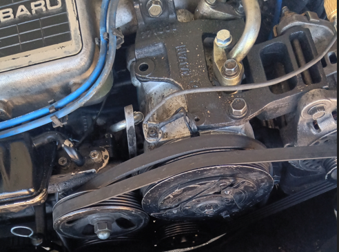

Hamm3y Posted August 31, 2023 Share Posted August 31, 2023 I trying to get my 1988 Subaru xt air conditioning working, but the belt is not fitting around the power steering pulley. If any one know where I could get a new one or find a used one, I would really appreciate it! Link to comment Share on other sites More sharing options...

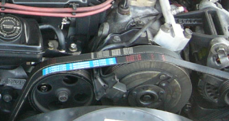

Hamm3y Posted August 31, 2023 Author Share Posted August 31, 2023 The belt is not the issue, it fits perfectly fine, its the power steering pully. There is not enough room for two belt, and its rubbing against the power steering mount. Every time I put the belt on the PS pulley and crank it over it just falls off. Here is a picture of a good belt set up. Link to comment Share on other sites More sharing options...
moosens Posted August 31, 2023 Share Posted August 31, 2023 Ok then let’s see your pulleys and alignment please. Tough to tell from your post but my first thought is somehow the tension is loose. Again, I’m not there and can’t see from here. There are plenty of hoarders somewhat. Catching them in a good mood at the right time is another story. Good luck. Link to comment Share on other sites More sharing options...
Hamm3y Posted August 31, 2023 Author Share Posted August 31, 2023 Thanks for your reply, Im talking to some junkyard to find the pulley. Just takes some time Link to comment Share on other sites More sharing options...

Rupart Posted September 1, 2023 Share Posted September 1, 2023 (edited) hi, i see in your pic that you have a p/s pulley that has only 1 belt position, you going to need the 2 belt version, close look at the two pics you posted seem to look like the single pulley is set back and the 2 belt one is set forward allowing the second belt room to fit. i will try to post another pic showing the idler pulley and bracket that is also on the rear(2nd) belt, if your setup does not have this you gonna need it. well my pic was too big and i am not allowed to post it. this idler is also an adjuster setup for the rear belt so check it out. it's all down under the compressor. Edited September 1, 2023 by Rupart forgot to add Link to comment Share on other sites More sharing options...
