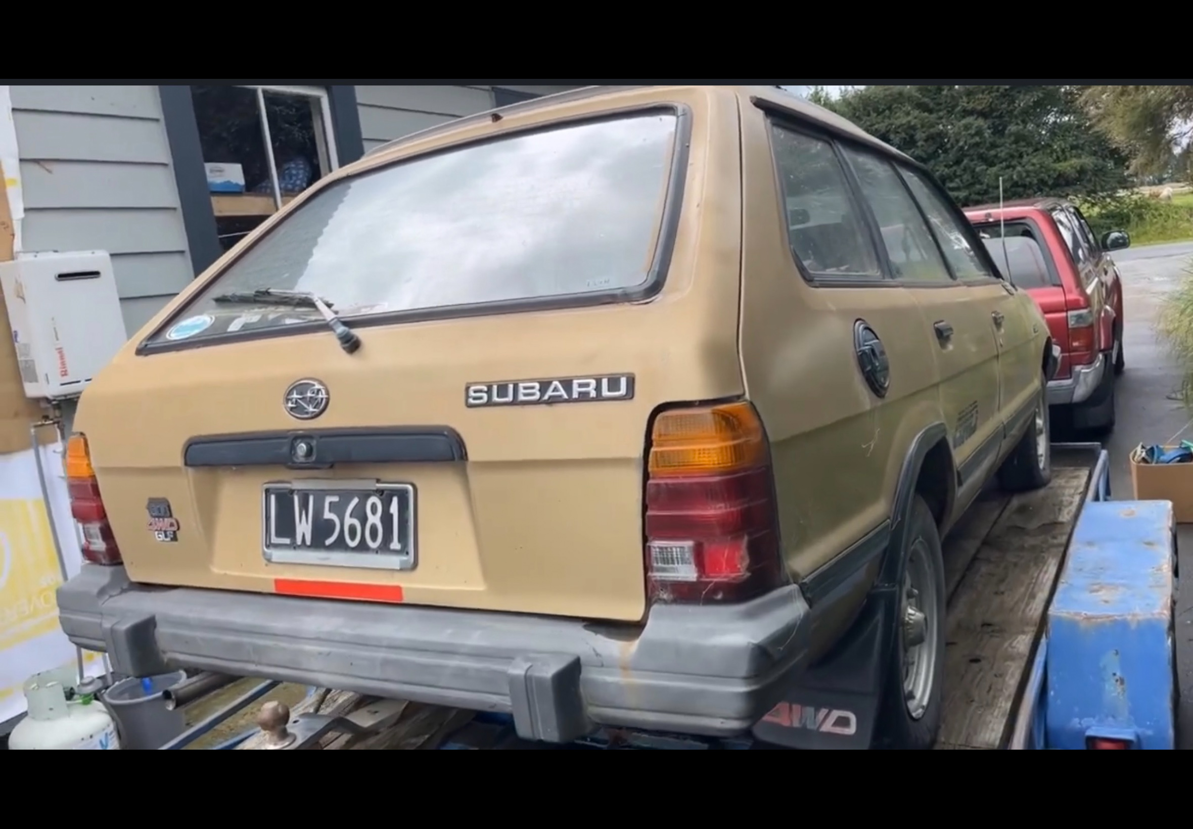

Westy Gen2 Posted October 12, 2023 Share Posted October 12, 2023 (edited) Hi all:) As a teen of the 80’s,was occasionally allowed to borrow my dads, then new,84 Touring Wagon to take mates skiing. At the time here in New Zealand,after years of struggling on the ground in the slush and mud,it was quite the novelty to bypass the snow chain car park ,and do the royal wave as the attendant waved you uphill due to the 700 stickers on the gen 2 Subaru Touring wagon that denoted it had 4wd,wow! A few decades on,nostalgia kicked in,so after 25 years of restoring early two door range rovers,dumped that marque and went in search of a 80’s high roof touring wagon. Having driven or owned most of the later models,still came back to that unique and fun driving experience in the Gen2. Joined up on bookface to put the word out on a kiwi old school Subaru group,and after a month or two one popped up that was exactly the year and model I wanted. Bought sight unseen,had sat outside and undercover for 15 years but in the photos,looked ok,,,how naive! Anyway,thought I’d post up a timeline of what I’ve learnt and done so far. (These are the pics on bookface for sale 500km away) (The site can’t currently process a membership upgrade to increase pic data,so have had to remove some posted images to complete rebuild thread ) Edited November 28, 2023 by Westy Gen2 1 Link to comment Share on other sites More sharing options...

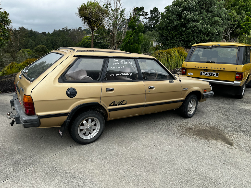

Westy Gen2 Posted October 12, 2023 Author Share Posted October 12, 2023 (edited) It took some time ,but eventually tracked down the original owner.Now in his 90’s,this was his wife’s car,Marjory,so literally one lady owner since new. He had issues with it idling and was starting to develop some rust,so it failed a warrant of fitness check and was parked up since 2009! Some years ago, he rang a wrecker to collect it for metal scrap,the truck got lost as they were rural in the wop wops so it sat again for many years until a contractor working on the property said he’d take it,and that’s where I saw it posted up for offers. Towed back to mine using a mates custom made triangle metal frame that attached to the front towing eyes. This was the sketchiest thing I’ve done for a long time,took all the slow backroads as best I could as any hint of a corner would send the freewheeling front wheels hard over until some speed straightened them out!! Had a cop trailing me for a short time,until he hit the lights and sirens and gunned it past me to something more important,,don’t mind saying that raised the heart rate. Anyway she looked pretty good sitting on the drive back at home. Edited October 12, 2023 by Westy Gen2 1 Link to comment Share on other sites More sharing options...
Westy Gen2 Posted October 12, 2023 Author Share Posted October 12, 2023 (edited) Initial Inspection walk around As you all know,,you only see the top of the icebergs… “Here Mousey Mousey” Edited October 15, 2023 by Westy Gen2 1 Link to comment Share on other sites More sharing options...
