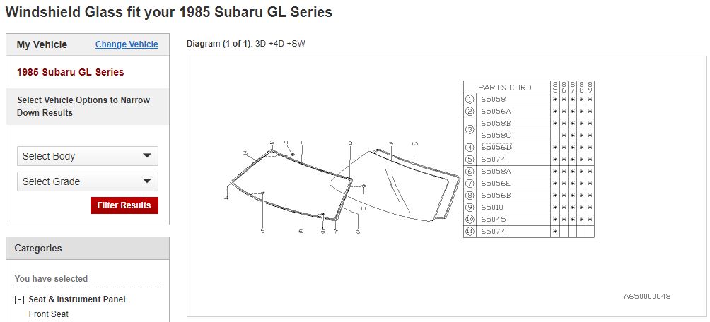

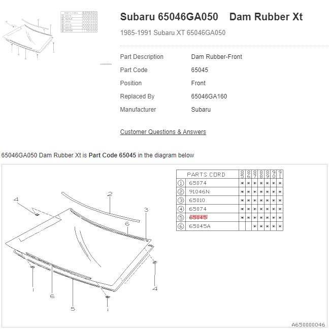

Checkerboard Comet Posted January 15 Share Posted January 15 Hey gang, I found a new windshield rubber seal online for sale (part number: 65046GA050), which says it's for an 1985 XT model. I need a replacement one for my 1985 GL (part number: 65046GA060), but those appear to be discontinued EVERYWHERE I look. My question is, are they the same part (just a different number because their for different vehicles, but may be the same windshield design)? When I compare the data tables between BOTH models, they both share the same part number series...........so they look to be the same thing? I don't know anything about the XT, anyone care to confirm if the windshields are the same with the GL's? Note: It shows both vehicle types share the 65045 series (part 5 on the XT, part 10 on the GL). Link to comment Share on other sites More sharing options...
carfreak85 Posted January 29 Share Posted January 29 Pretty sure the EA82 and the XT DO NOT share the same gasket. Link to comment Share on other sites More sharing options...
