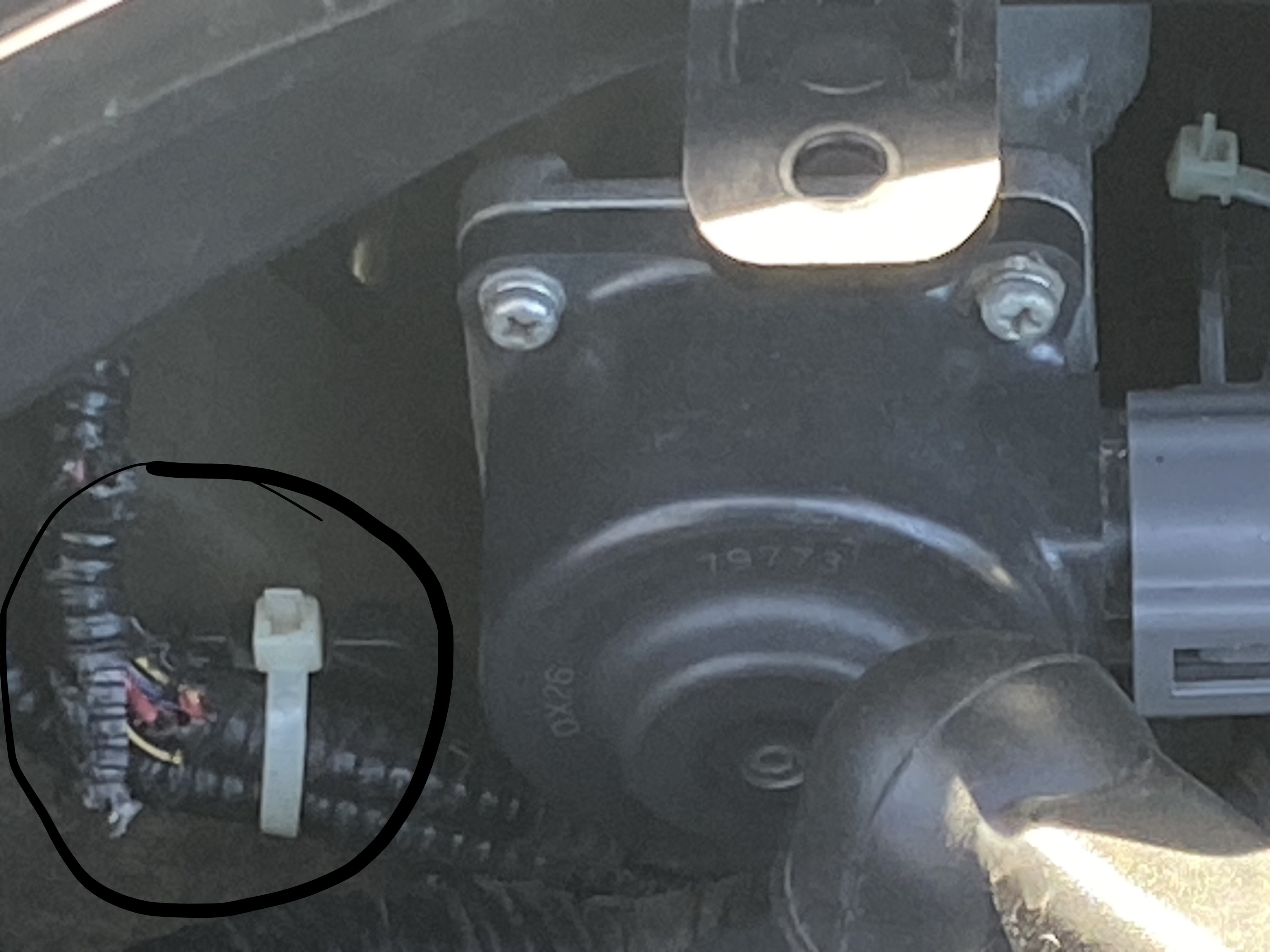

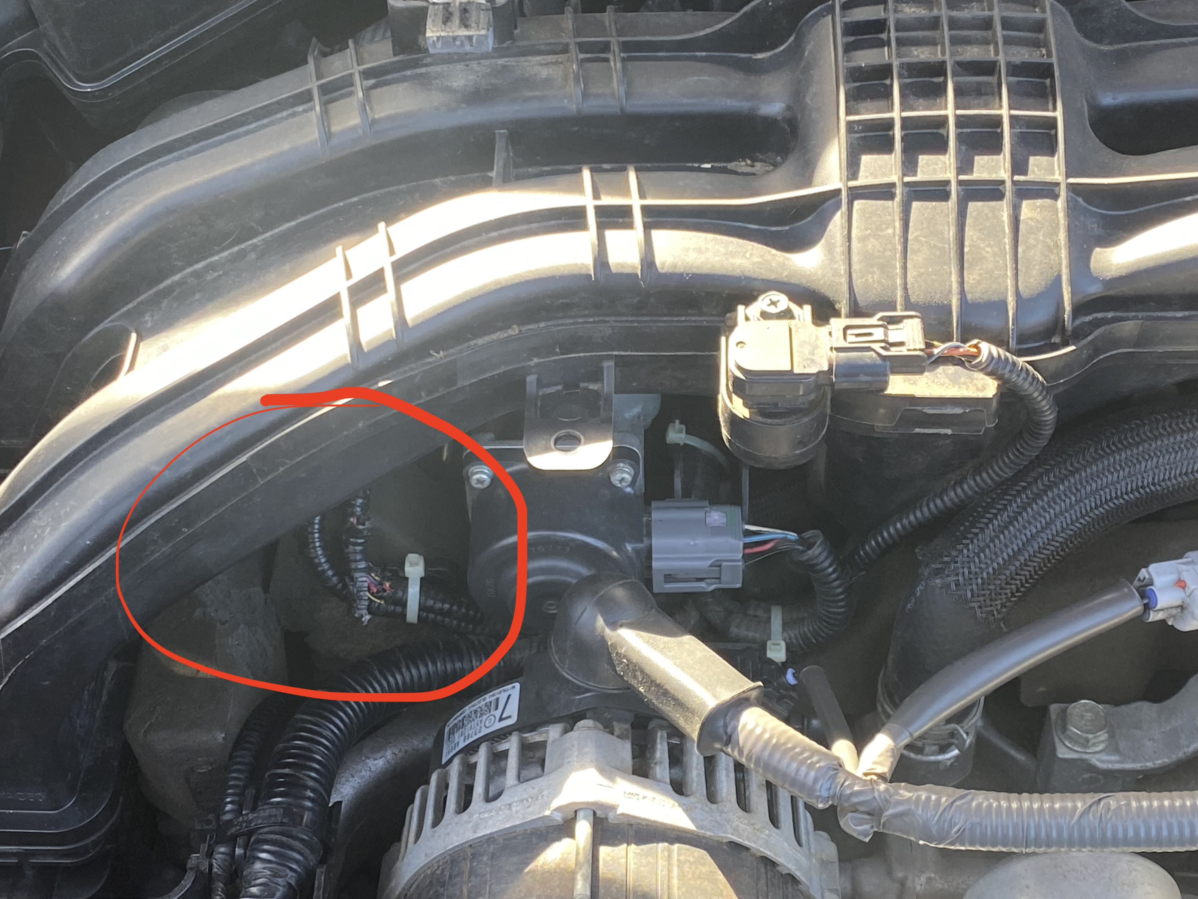

BlueRidge Posted February 29 Share Posted February 29 Good afternoon. I have squirrel damage to the engine of my 2021 Subaru Forester Touring. I'm looking for some insights on what part of the engine is involved (see pictures below). By the ODCs the car is throwing, it seems to be related to the fuel pressure sensor - but that could be the result and not the actual damage itself. Any help is appreciated. Thanks Link to comment Share on other sites More sharing options...
lmdew Posted March 1 Share Posted March 1 Have to open up the wire harness and repair the wires. If you pull up the FSM you may be able to see what components the harness is going to. What codes do you have? 1 Link to comment Share on other sites More sharing options...
idosubaru Posted March 1 Share Posted March 1 Is it covered under your insurance policy? That's in a very bad area and good chance it's causing the codes. Splice the broken wires to repair or replace the entire harness, Subaru will have those in stock (i think). Subaru will only replace the entire wiring harness, they will not repair the current harness. At least all the dealers I know won't, maybe there's a few willing to "break the rules". 1 Link to comment Share on other sites More sharing options...
BlueRidge Posted March 2 Author Share Posted March 2 Thank you both for the feedback. I'm pulling the intake manifold to create working room and going to try to repair before considering replace. Link to comment Share on other sites More sharing options...

idosubaru Posted March 3 Share Posted March 3 On 3/1/2024 at 8:28 PM, BlueRidge said: Thank you both for the feedback. I'm pulling the intake manifold to create working room and going to try to repair before considering replace. I’ve repaired a few rodent damaged harnesses. Besides diagnosing and tracing them to under carpet wiring, or hidden areas, they were all easy repairs, never had repeat issues. One or three are broken completely, another is abraded, splice them all, wrap, and on your way. Good luck! Link to comment Share on other sites More sharing options...
