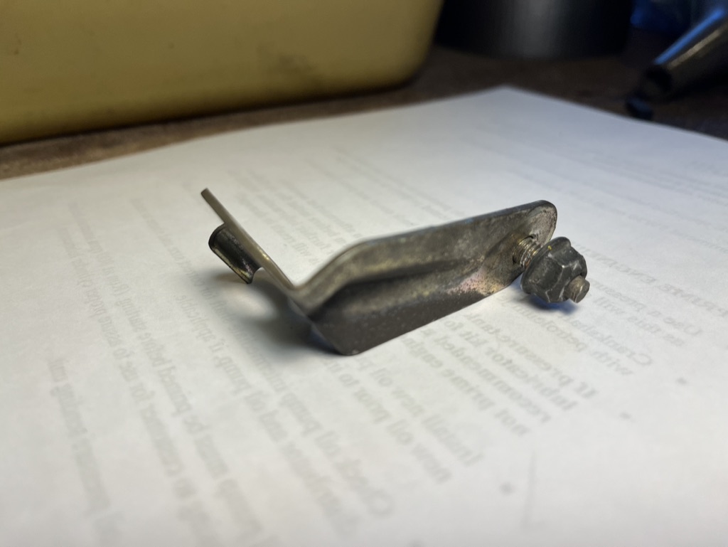

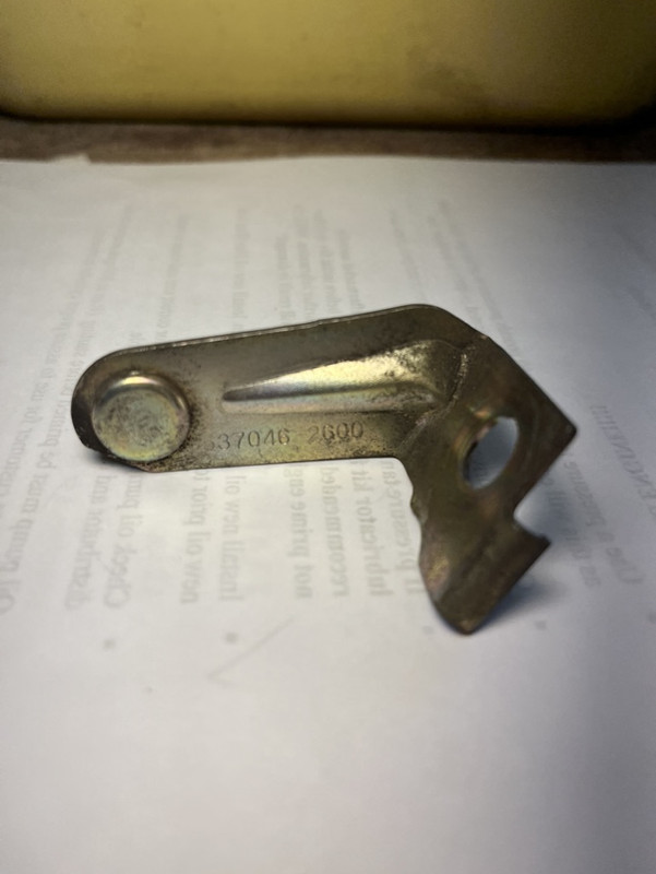

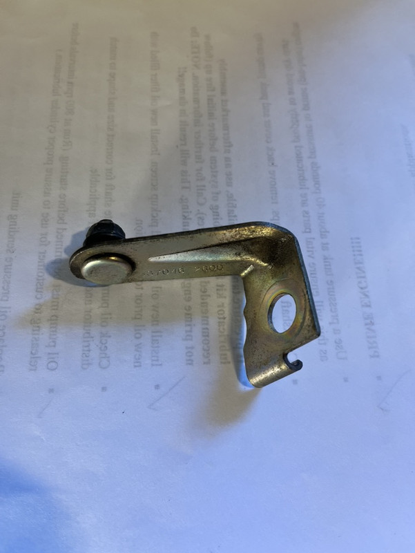

Johnny Subaru Posted May 13 Share Posted May 13 Hi there - does anyone know what this part is? Finishing up a rebuild on my '99 Outback EJ25 DOHC. And Ive got this one part I don't know where it goes. Cant find it anywhere online, went in to Subaru and they don't even know. The number engraved on it is: 537046 2600 Below are links to photos of it. Thanks in advance https://i.postimg.cc/bJwqM0KM/92-FA6...EA-1-105-c.jpg https://i.postimg.cc/d04Y8kL9/F78405...F2-1-105-c.jpg https://i.postimg.cc/CLPrHGN5/293-FD...69-1-105-c.jpg Link to comment Share on other sites More sharing options...

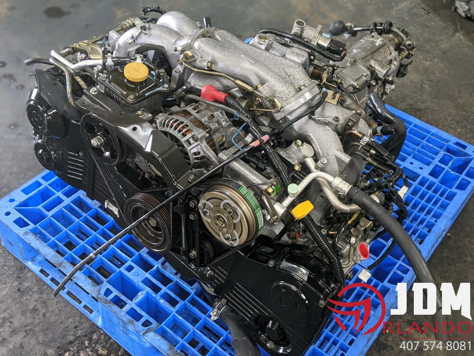

Numbchux Posted May 13 Share Posted May 13 (edited) It provides a mount for the A/C belt cover. EDIT, here's a picture that shows it. Under one of the A/C compressor bolts Edited May 13 by Numbchux Link to comment Share on other sites More sharing options...
