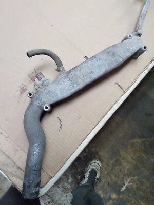

nvu Posted May 28 Share Posted May 28 the hoses are formed, but you could get away with whatever is closest to its shape. take your phone and peek around down there. you should see this thing. that's where the hose comes from. it's deep down in there. removing the intake is the recommended way, but why not try the throttle body first, it's just 4 bolts Link to comment Share on other sites More sharing options...
ocei77 Posted May 29 Share Posted May 29 Needle nose pliers should work w/o removing anything. That picture only shows the source of one hose, There is one more from the bypass tube from the water pump that sits alongside the crossover, The tubes have a tendency to rust at the bends. http://static.opposedforces.com/epc_img/371494803501.pngSee: Subaru IMPREZA — Subaru parts catalog (opposedforces.com) 1 Link to comment Share on other sites More sharing options...
