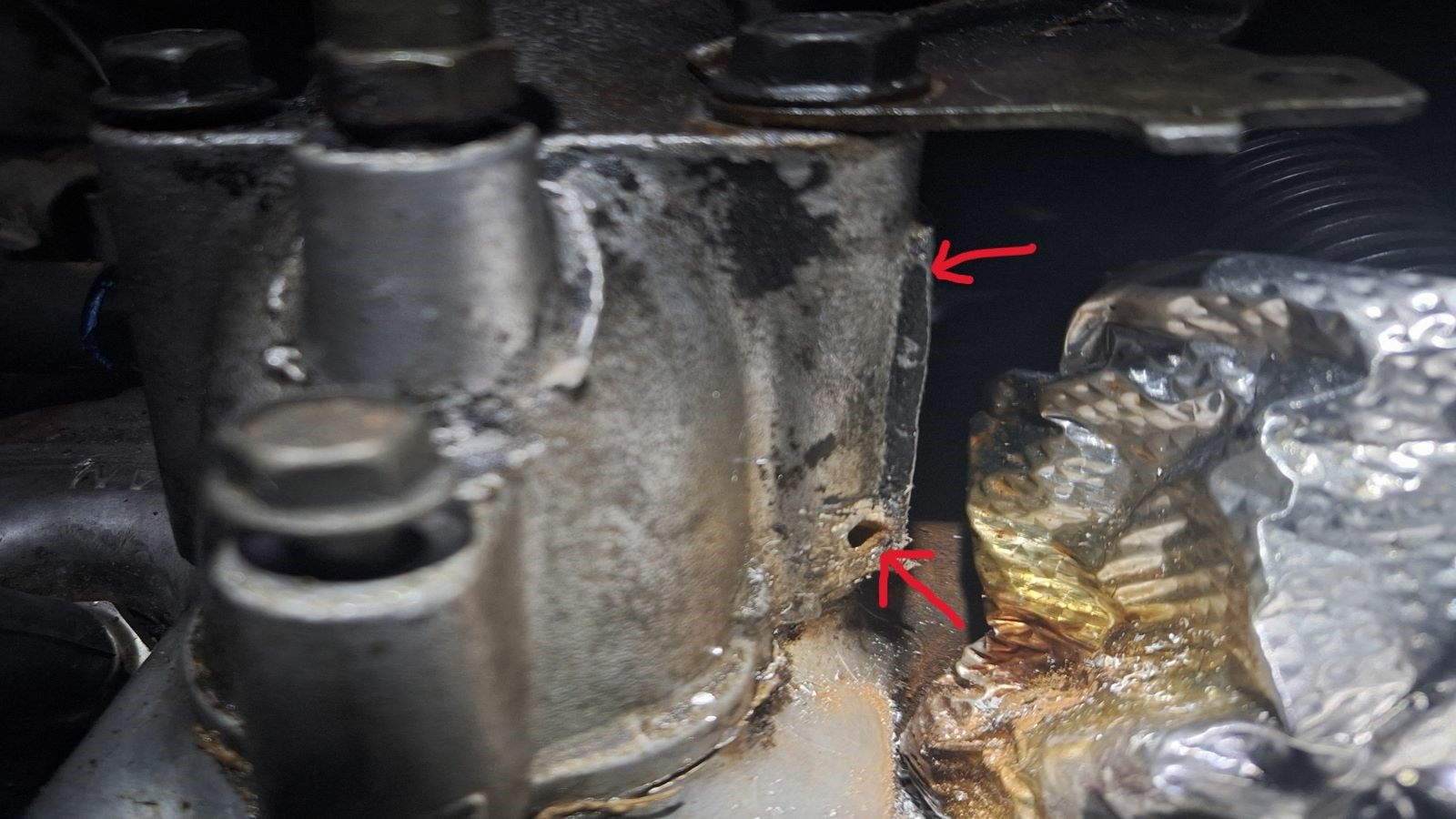

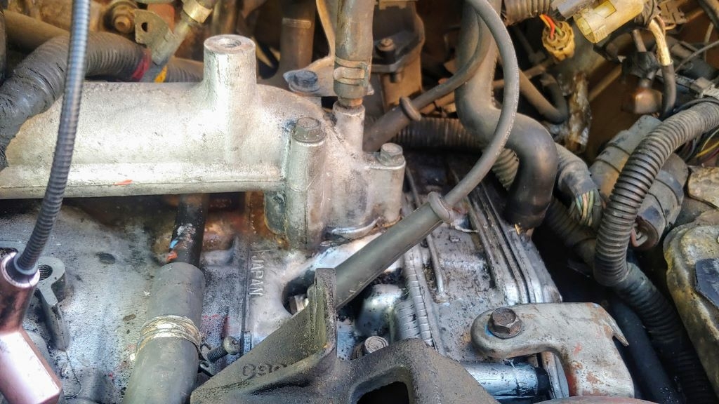

Craigar Posted September 2, 2024 Share Posted September 2, 2024 93 Loyale EA82 SPFI Whilst replacing my water pump etc. I discovered another problem - the right side (by alternator) intake manifold is leaking coolant, which I suspected for a few years.. and the back long bolt is stuck / frozen - and so are the 2 long ones on the passenger/left side also... I soaked their heads and around the gasket (where we need really need it but probably can't get past the gasket) with liquid wrench and have to take care of other business so it will be a month before I can get back to it. Read through lots of good ideas for stuck bolts BUT these long intake manifold bolts have the head of the bolt more than an inch and a half from the stuck threads going into the head so I don't think many of those ideas will work. I'm thinking a 6 point impact socket, impact wrench and maybe first drilling a small hole into the manifold close to the base of the bolt, about a quarter inch above the head that I can load up with some fancy "nut buster" sauce, I have liquid wrench from 20 years ago but maybe their is something a lot better now? Here's some good ones https://www.ultimatesubaru.org/forum/topic/44039-what-are-my-options-with-this-stuck-bolt/#comment-354824 Link to comment Share on other sites More sharing options...

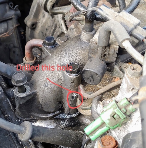

Craigar Posted December 8, 2024 Author Share Posted December 8, 2024 (edited) I was gone for about 2 months and I finally got back to working on this car and ended up drilling a small hole on the outside corner of the manifold where the bolt goes down to try to get penetrating fluid or blaster down in there and then went and got myself a modern 225 foot pound max rigid torque wrench gun and I haven't broke any of the 3 bolts loose yet, so I guess I gotta go get me M.A.P. Torch, thanks for the good suggestions. Edited December 15, 2024 by Craigar had image in wrong album Link to comment Share on other sites More sharing options...

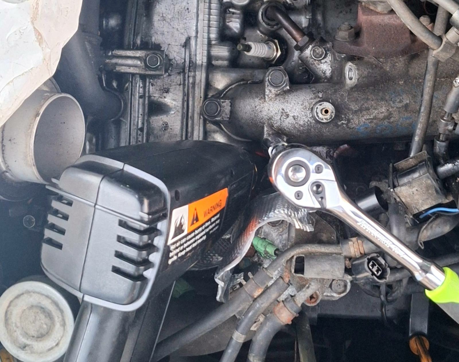

Craigar Posted December 15, 2024 Author Share Posted December 15, 2024 (edited) .. and about a week ago I sprayed em with my 20 year spray can of Liquid Wrench, - which I discovered 3 days ago had lost all it's pressure probably cause I unknowingly banged the head on it, probably shutting the hood.. So I bought a new spray can of B'laster and sprayed and soaked it a few more days - no cigar So here's the specs of a very nice portable 3/8" torque wrench I just bought from Home Depot on sale for $140 with battery and charger Lightweight Design. Heavyweight Performance. Pair with MAX Output batteries for maximum power Industry’s most compact Powerful Brushless Motor delivers 250 ft./lbs. of breakaway torque 3 speeds + auto-tightening mode provides adjustable power and speed Auto-tightening auto-stops when fastening to prevent over tightening bolts Auto-tightening in reverse, delivers full breakaway torque, then stops when the bolt is loose Tri-Beam LED enhances visibility and provides even distribution of light Compatible with RIDGID’s AC13B04N Impact Wrench protective boot (sold separately) 100% Compatible: Works with all RIDGID 18V Batteries, Tools, and Chargers Lifetime Service Agreement with registration within 90 days Includes: R872071 18V SubCompact Brushless 4-Mode 3/8 in. Impact Wrench, R87002 2.0 Ah battery, charger, belt hook with screw, and tool bag RIDGID: Build for a Lifetime 18V SubCompact Brushless Cordless 3/8 in. Impact Wrench Kit with 2.0 Ah Battery, Charger, and Bag and it didn't seem to move any of em at full torque, even trying in both directions.. So I cleaned the oil + road dirt mix off the passenger side intake manifold area (to lessen the chance of a bon fire) and only M.A.P. torched it for about 3 minutes total cause I've never done it before and was getting smoke and embers and nervous and cold and it was now dark outside where I'm working on it and the crappy harbor freight "free head lamp" was turning off all on it's own way to much - even after messing with it a lot.... and "amazing to me " got the bolt loose closest to the windshield loose! BUT it didn't want to go "looser" and "tighter" back and forth ( CCW and CW ) only looser so went about 2 turns and going to give it chance to soak more over night. - and the head wasn't really very hot, maybe 110 F. Progress, not perfection ... One down, two to go Grrrr ,, I mean "patience..." Edited December 15, 2024 by Craigar 1 Link to comment Share on other sites More sharing options...

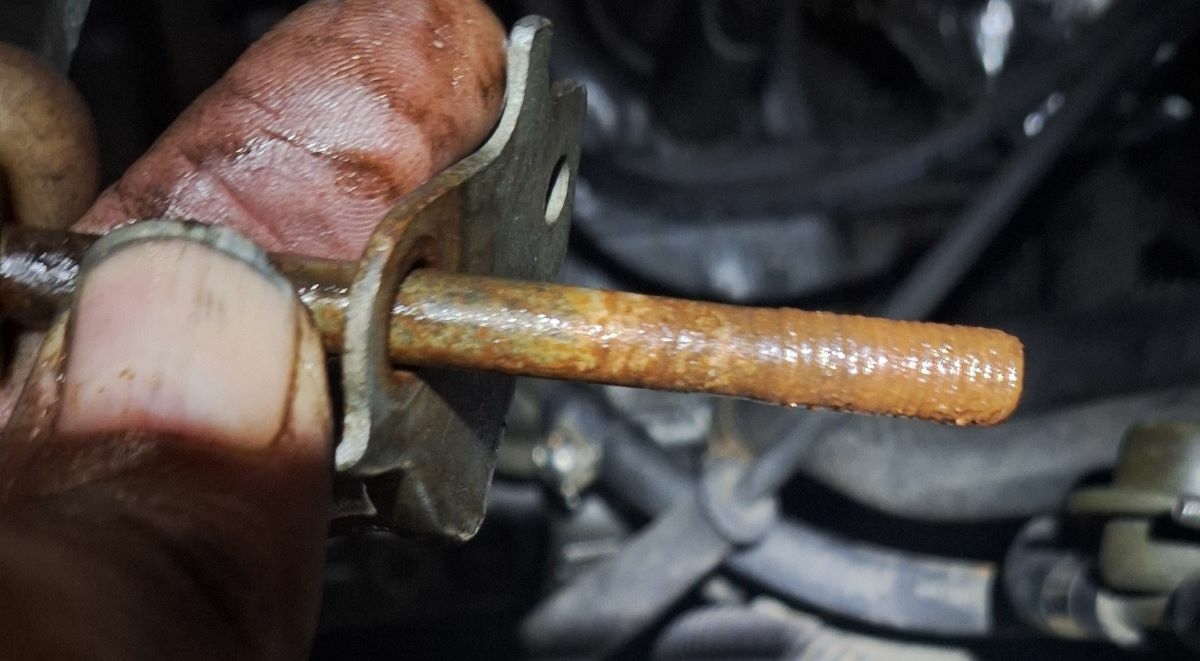

Craigar Posted December 20, 2024 Author Share Posted December 20, 2024 (edited) Got em all out without breaking any - I don't think Ive stripped the holes either but haven't cleaned it up yet. For this really tough bolt I decided to use a "paint stripper" heat gun on high for about 15 minutes and it still wouldn't budge so drilled a 2nd hole down closer to the threads, earlier had drilled a hole about in the middle of the column to get the penetrating oil down into the crud in the bottom inch of the column also. After drilling this second hole and then using a lot of penetrating oil, then heat, I had progress had to heat up down by the head for at least 10 minutes with paint stripper heat gun, that's why my aluminum shield has turned golden brown .. I tried a M.A.P. torch but it was to scary and causing way to much smoke for my comfort.. and wiggled back and forth tell I could get about 1/4 turn, came back next day tried it cold no t so much movement so heated it up again and kept working it back and forth - but not going as far in as out.. then add more sauce.. do it again and eventually.. Here's the bolt right after I got it out - I used a lot of B'laster penetration oil, and couldn't get it moving with the 3/8" impact gun - had to really push and pull on this ratchet - really hoping the bolt wouldn't break,, kind of amazed it didn't Edited December 20, 2024 by Craigar more bloody details.. 2 Link to comment Share on other sites More sharing options...

Craigar Posted December 21, 2024 Author Share Posted December 21, 2024 (edited) Thank you! The bolts didn't break probably cause they're hardened or tempered, they have a #7 on the top of the bolts. Yea first I'm going to hit the bolts and threads with a wire wheel but probably use a die on this particularly bad rusted one - the rest didn't look as bad - 3 of them came out easily. Will see Started a new topic for doing the gaskets and hopefully getting it back together without putting some of the spaghetti back in the wrong holes.. https://www.ultimatesubaru.org/forum/topic/186408-ea82-replacing-manifold-gaskets Edited December 21, 2024 by Craigar Link to comment Share on other sites More sharing options...
