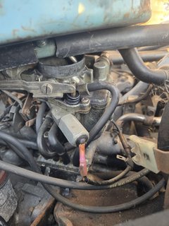

Justineg07 Posted Monday at 12:55 AM Share Posted Monday at 12:55 AM (edited) Wire completely fell off.... Working on a 1978 brat. I didn't realized how hard it is to find parts https://i.postimg.cc/0NpXF4FC/20241110-161411.jpg Edited Monday at 12:59 AM by Justineg07 Link to comment Share on other sites More sharing options...
moosens Posted Monday at 02:14 AM Share Posted Monday at 02:14 AM Anti-Dieseling device. Yes I’ve seen that wire break off at the end of the metal. Let me check as I can. I’m currently cleaning house of over 40 years of Subarus and the 70s are my main focus. If you go on eBay you’ll see I have a lot of 70s and I have or had a carburetor listed. I know you don’t need the whole carb but just for reference. And that’s a rebuilt carb. “cashingmystuffin” is my eBay name. More than likely if you just lightly touch a soldering iron to it you can set that wire back on well enough. Good luck. I’ll try to post more later about the anti dieseling switch. Link to comment Share on other sites More sharing options...
