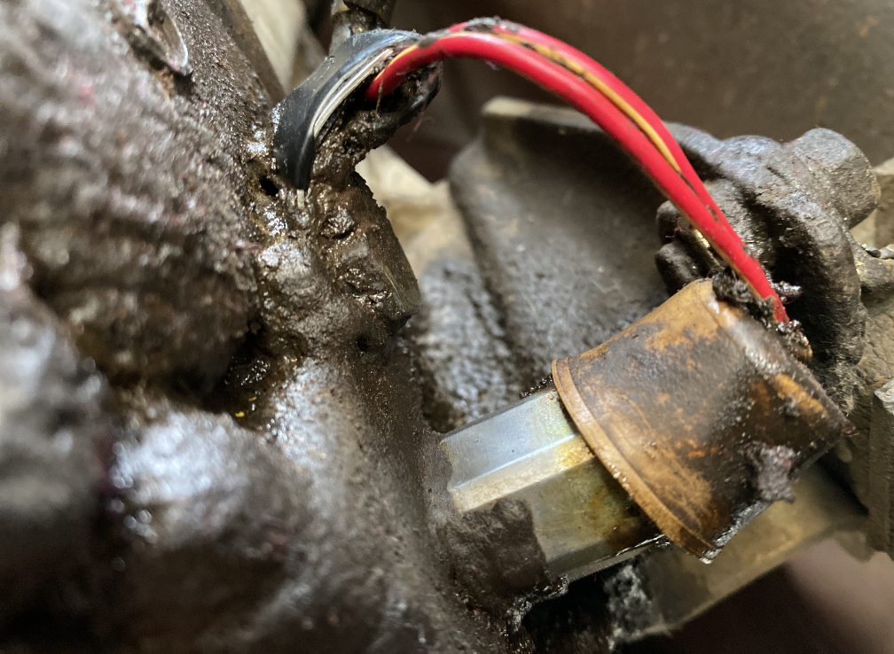

Ellewas Posted November 23, 2024 Share Posted November 23, 2024 (edited) Hi! Thank you all for having me, I was digging around under my Subaru trying to track down a leak, and it seems to be coming from what I believe is a sensor. Photo below! Edited November 23, 2024 by Ellewas Found out how to add a picture Link to comment Share on other sites More sharing options...
moosens Posted November 24, 2024 Share Posted November 24, 2024 Reverse lamp switch. There’s a gasket behind it that measures 14.2x21x2 1 Link to comment Share on other sites More sharing options...
Ellewas Posted November 26, 2024 Author Share Posted November 26, 2024 On 11/23/2024 at 4:54 PM, moosens said: Reverse lamp switch. There’s a gasket behind it that measures 14.2x21x2 You are an absolute legend thank you so much! I'll get a new gasket right away! 1 Link to comment Share on other sites More sharing options...
