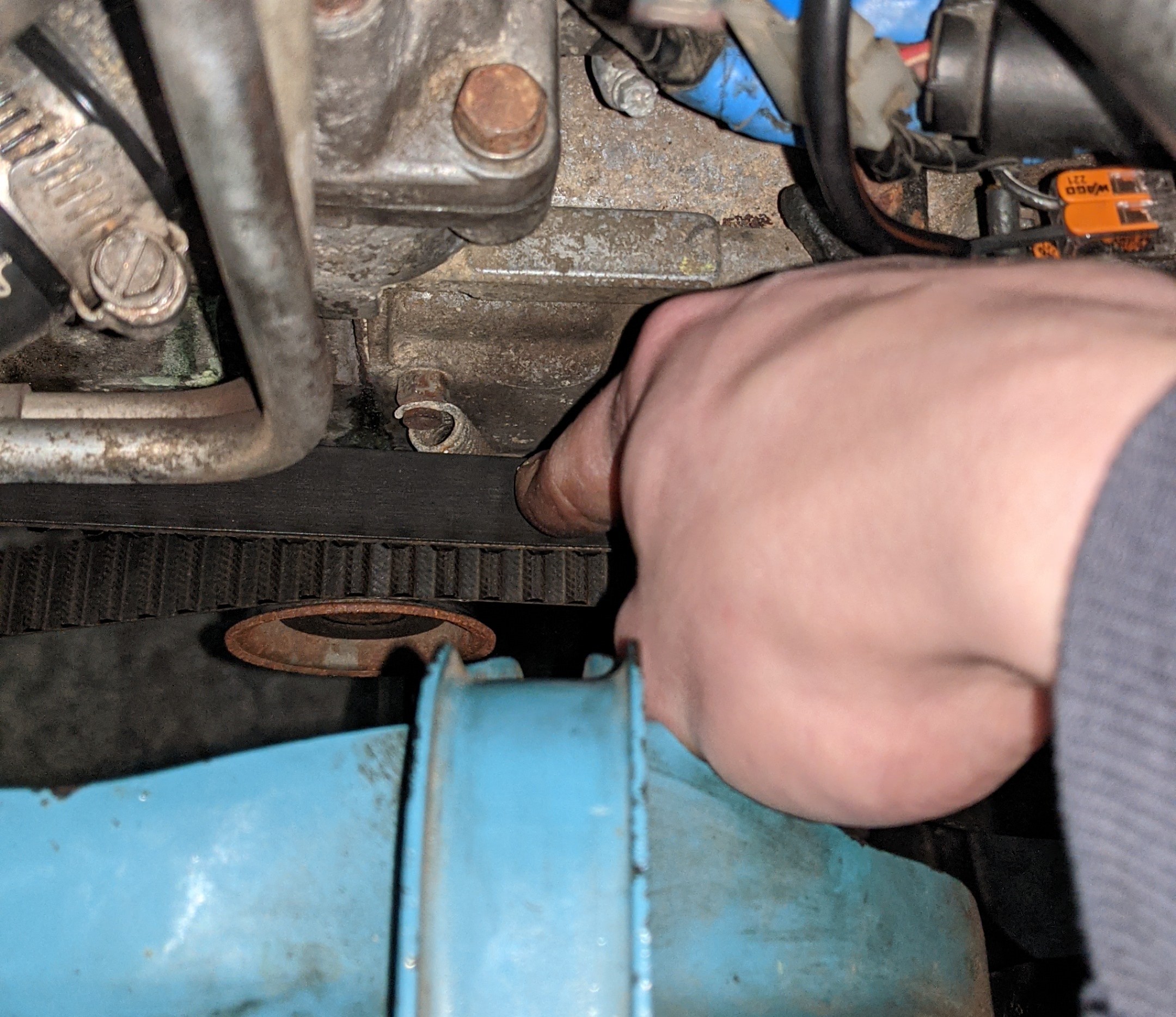

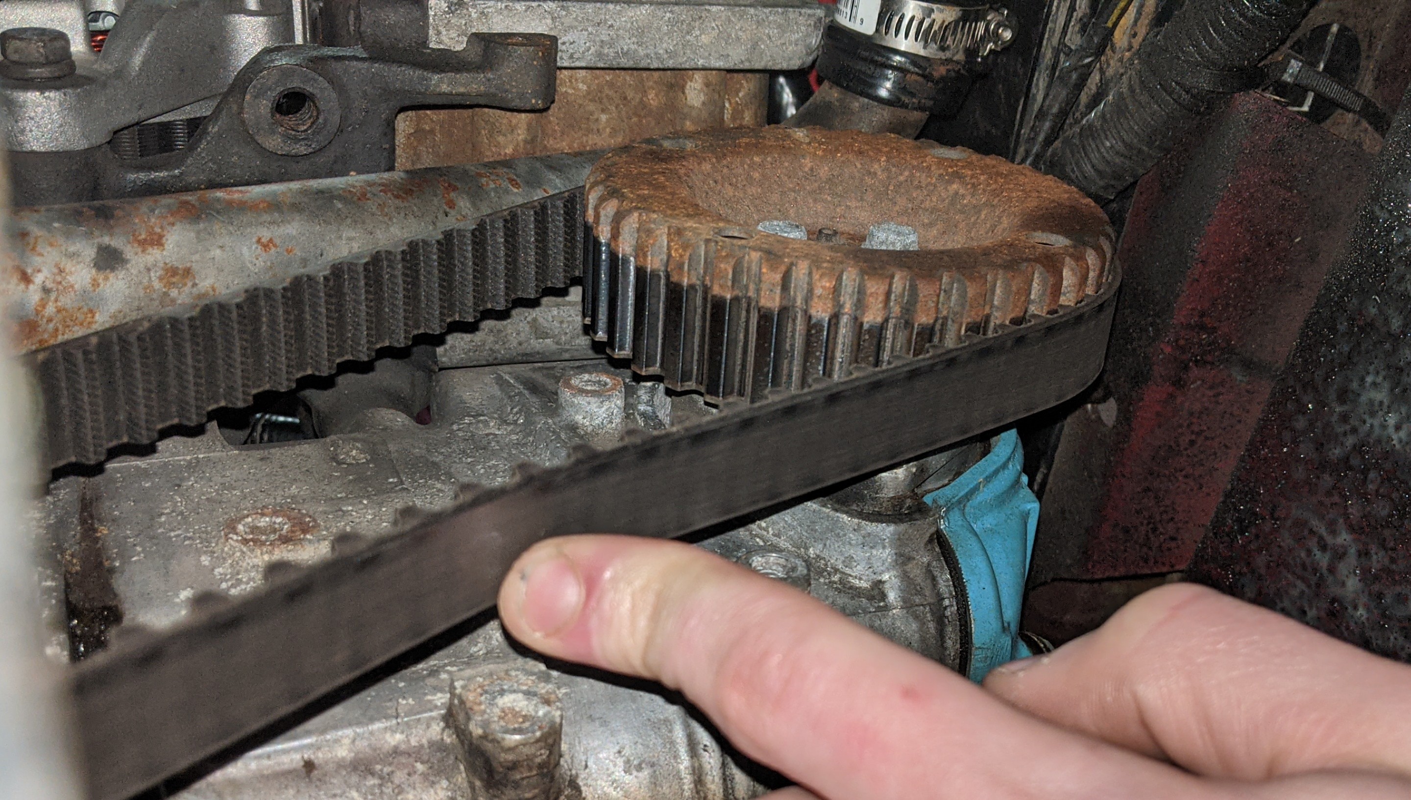

SuspiciousPizza Posted December 15 Author Share Posted December 15 Quick check of CTS, dizzy, and belt. CTS: Solid ground, 0.5 ohm resistance to ground. Haven't done the water temp test yet as I don't want to drain coolant for the umpteenth time if unnecessary. Dizzy: I can rock the car by the dizzy rotor. Dizzy seems solid in it's mounting. Belts: Uh-oh! I can deflect the belts with one finger (see images for where the most play is) I know belts have a high-tension side and a low-tension side but perhaps my belt has stretched beyond limit? I have a factory service manual to follow, but any belt service procedure in layman's terms would be helpful as cross-reference. :] Noah Link to comment Share on other sites More sharing options...

moosens Posted December 15 Share Posted December 15 That crusty return spring on the belt tensioner could use some help. Guessing the tensioner pulley pivot could be sticky too. Check that manual and see how much belt deflection there should be. Link to comment Share on other sites More sharing options...
SuspiciousPizza Posted December 16 Author Share Posted December 16 Replaced the timing belts, tensioners, and pulley. All went well. Started up, but I still had to keep my foot down. When I lifted my foot it did it's "normal" flutter idle at 250 RPM whereas before it was at 750 RPM (before it'd die below 500 RPM so small victory). Loud clicking from the center of the engine still there. As I went to go check on the clicking, it was PISSING coolant from the radiator cap. Well that's new. Could a head gasket issue cause the flutter and coolant leak? I'll keep posting as I chase this cornucopia of mysteries. Any suggestions or ideas are always welcome. :] Noah Link to comment Share on other sites More sharing options...
