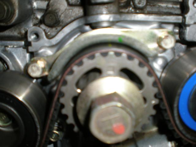

rverdoold Posted January 1 Share Posted January 1 Would more suspicious the timing is well off. A hard shift can cause to have a load on the crank and when the timing belt tensioner is broken/loose or just bad you can skip couple of notches. Normally manual gearboxes have a protective guide over the crank-axle sprocket to prevent tooth jumping. Just in case this piece is or went missing it could have happened. Check the metal plate in this (see this unsharp image just above the sprocket) from this thread. 1 Link to comment Share on other sites More sharing options...

Bobthecat01 Posted January 2 Author Share Posted January 2 I didn't put oil in the plug holes and recheck compression. My battery is good as far as I know. It was cranking quickly and I had 12.6 Volts before cranking, should be plenty. The gauge would jump up the 30 and stay there. The timing marks were dead nuts on both cams and crank too. The only way I could see the timing being a problem is if the crank pulley slipped exactly 180 degrees and miraculously landed back on the timing mark? I don't have the protective plate over the crank sprocket, this thing has jumped time on me twice before during similar hard-turns open throttle situations and I've always been able to reset the belt and fix it. The last time it happened I replaced the tensioner and pulley. Link to comment Share on other sites More sharing options...
