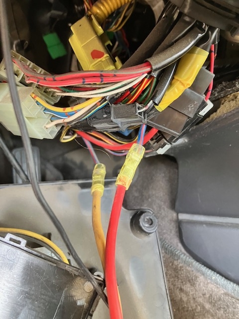

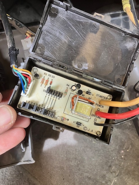

gros ventre Posted March 3 Share Posted March 3 im try to track down why my 1995 subaru is not receiving a signal to the speedo and found something electrical that doesn't seem to belong wondering if anyone can tell me what it is Link to comment Share on other sites More sharing options...
nvu Posted March 5 Share Posted March 5 I only see one wire tapped from the main harness. can you trace blue/pink wire and see if it runs into the ignition switch? guessing it's a breathalyzer module that needs breathing into to start the car. Link to comment Share on other sites More sharing options...
gros ventre Posted March 5 Author Share Posted March 5 i just said oh well and cut it out and reconnected the wire seems to work without it thankyou for the reply Link to comment Share on other sites More sharing options...
