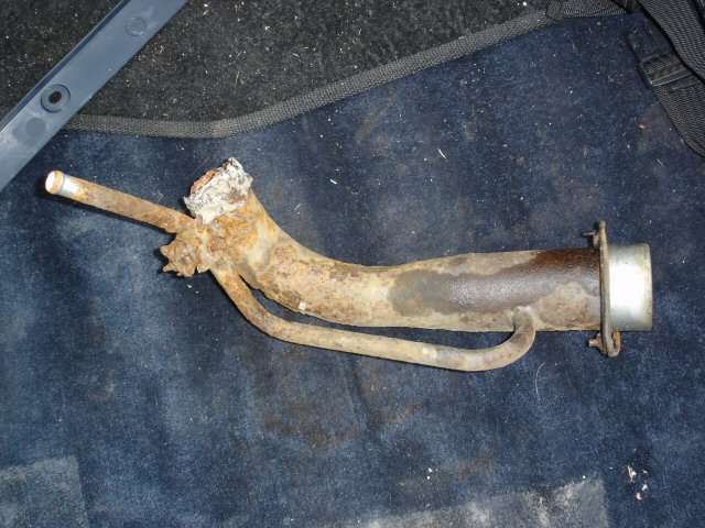

fluffy Posted September 18, 2004 Share Posted September 18, 2004 Well, I've been the proud owner of an '86 GL 3-door "Sport" since May, but for the last month or two, I've been having some problems. It's the EA82 1.8l carbie, btw... The biggest problem, and also the most recent, is that I can't actually fuel up. Every time I try to put fuel in, it just comes out the overflow. I tried using a piece of copper wire to feel around in the filler tube, but it didn't feel like anything was clogging it. I've only got about 1/8 of a tank left, so I'm not sure I could make it to the nearest good Subaru mechanic. Another problem is that the rear suspension is very creaky, but only in dry weather. With all the recent rain, it's perfectly silent. Shocks probably need replacing, as the car rides a little low in the rear. I've been having a couple engine problems too, particularily hesitating from a stand-still. I've replaced the distributor cap and rotor already, and the plugs are good. The battery is 6 months old (taken from my girlfriend's dead Camry), the ignition wires look good too, and the fuel and oil filters are only 4000 clicks old. I changed the oil when I replaced the filters too... The tach jumps around quite a bit on a cold start or if I have the fan running, and the engine misfires when the rear defroster is on (and sometimes the fan). The alternator puts out enough juice, since volts are up around 13-14 when driving and solid at 12 at an idle, so I think it might be the ignition coil. Those are the main problems, the lesser ones being crappy speakers and squeaky brakes, though I know what to do about those. One kinda funny thing though is that I thought I needed a new muffler since mine rattles a lot, but after lifting the car and looking under it, the muffler looks fine. Beating it a bit with a rubber mallet though I found the rattle is in the air heater, and something (a rock or tool of some kind - amazing how many sockets I found in the car) is rattling in the pipe or heater. This means I have to remove the entire exhaust system to get whatever it is out of there. So if your muffler sounds like a marble in a tin can, beat it with a mallet! Anyway, if anyone knows a possible solution (or wants to fix my car for me; I'm in Duncan, BC, btw...) please let me know, as I'd love to get my car fixed up. I've posted a pic of my GL so everyone can drool on it's sexy contours (actually it's not too bad. hardly any rust) Thanks all, and sorry for the long read... Link to comment Share on other sites More sharing options...
fluffy Posted September 19, 2004 Author Share Posted September 19, 2004 Well, I pulled the wheel and shroud off my car, and the filler tube is completely rotten. I need a new one. I'm scouting a few wrecking yards today, but if anyone has a filler tube that would fit, let me know. I'm in Duncan BC, though I could probably travel a little ways... Thanks Link to comment Share on other sites More sharing options...

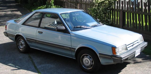

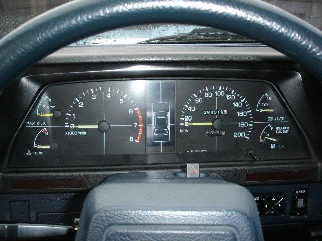

subeman90 Posted September 19, 2004 Share Posted September 19, 2004 your car does have a hatchback but it is known as a 3 dr. a hatchback is totally different then the car you have. Just a little FYI. Also, i like the car...looks good and clean. Also since you are in BC I assume your cars speedo is in klm as opposed to mph? If so send me a pic if you can...i never saw one in metric. subeman@aol.com Welcome to the board! you will find a bunch of good stuff here and a bunch of good people out on your side of the country. Matt Link to comment Share on other sites More sharing options...

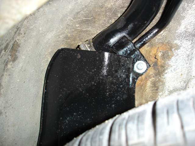

fluffy Posted September 20, 2004 Author Share Posted September 20, 2004 Thanks for the info, Matt, I've changed the subject to say 3-door now. Thanks for the compliment, btw, and I'll try and pick up some film tomorrow, as I don't have a digicam yet As for the fuel filler pipe, I ripped that all apart (had to take the wheel off too) and clamped a tin can around it. It doesn't leak anymore, but I'll still try and pick up a new fill pipe tomorrow. I think my power problems have something to do with the amount of rust in the fill tube, since some might have fallen into the tank... I hope not, but who knows... Link to comment Share on other sites More sharing options...
subeman90 Posted September 20, 2004 Share Posted September 20, 2004 Since you don't have a digi camera don't worry about the pic. it isn't that big of a deal.... When you do the filler neck you might want to plan on removing the tank. The strainer in the tank most likely has rust crap all over it and is most likely to be strangling the fuel pump which will sooner or later die. Like I said...don't worry about the pic. does that car even have any rust on the body? Wow that thing is cool. (I always had a thing for the 3dr) Matt Link to comment Share on other sites More sharing options...
fluffy Posted September 21, 2004 Author Share Posted September 21, 2004 Well, I did the filler neck yesterday (put some rust proof paint on it too), and don't plan on exerting myself too much right now. I might do the tank in the future, but I need to make more money first. Do you mean that I should clean the tank, or replace it? As for rust, yes there is some rust on it. The trunk has a dent in it, about an inch by 3 inches, and that's mostly rusted. The rest of the car though only has maybe 3 or 4 rust spots the size of a pencil eraser. The wheel wells have a bit of rust though, particularily the one the filler runs through. Other than that, for the $1000 cdn I paid for it, the body only has scratches and "parking lot dents" on it. The engine is pretty clean too... For pictures though, I think I can borrow a camera from work. I sell electronics, including cameras, and a couple of the other guys there have borrowed them before. *edit* btw, the filler neck cost me $65! Too much for a chunk of metal, imo... At least I found another hubcap there... Link to comment Share on other sites More sharing options...

fluffy Posted September 23, 2004 Author Share Posted September 23, 2004 Well, I got some pics for you Matt, the only thing is theyre BIG! I borrowed a 5-megapixel camera from work, so they're bloody huge pictures. If you want the full-size pics I can send them like that, but they're over 2 megs a picture. I'll scale them down if you want though... Btw all, here's a pic of the old filler pipe vs. the new one. The fatter pipe on the old one is supposed to be 2 inches longer, but those 2 inches broke off when I pulled it out. You can probably see the remains of the mounting screws in the top of the pipe too, as I had to drill 2 of them out. Link to comment Share on other sites More sharing options...
subeman90 Posted September 24, 2004 Share Posted September 24, 2004 Holy cow that thing was toast. How does it feel to fill up the tank the wole way now... Matt Link to comment Share on other sites More sharing options...

fluffy Posted September 27, 2004 Author Share Posted September 27, 2004 Well, I finally got around to converting that pic of the speedo for you, Matt... Here it is! Btw, if anyone can help me with my car problems still, that would be great. The main problem is with misfiring with a load on the electrical system (especially the rear defroster. it has a few dead lines, but I don't know if that makes a difference) Link to comment Share on other sites More sharing options...
subeman90 Posted September 27, 2004 Share Posted September 27, 2004 Thanks for the pic!!!! that is so cool having the metric gauges. Matt Link to comment Share on other sites More sharing options...
