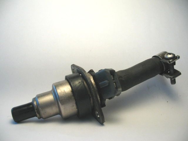

Ross Posted August 23, 2005 Author Share Posted August 23, 2005 Here is this injector i have. It has a dark green top (can't really tell in the pic) with A46-00 on the side. Tip is black, and thicker plastic that the subaru ones. What do you reckon? Link to comment Share on other sites More sharing options...
Gravityman Posted August 25, 2005 Share Posted August 25, 2005 As far as the tips(caps) go, The injectors can be rebuilt if the cap is broken or leaky the cap can be replaced hence it being black. What this looks like is a XT4 N/A or Turbo injector. The only thing that gets me is at the top between the hose and the green connector, mine is red but I cant tell what color yours is. I know that the red ones are used on the turbos, mabe black is only for N/A, mabe another reason your cap is black. I will run to the junkyard today and see if I can pick up some more injectors for testing and I will get some N/A EA82 injectors. Link to comment Share on other sites More sharing options...
Ross Posted August 25, 2005 Author Share Posted August 25, 2005 The bit where the hose connects to the green top is off-white on these ones. Link to comment Share on other sites More sharing options...
