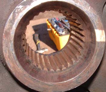

hooziewhatsit Posted December 18, 2004 Author Share Posted December 18, 2004 Hey all Got the hub off this morning. Around the outer edge the splines have a flat top about the size that CraigGT suggested they should be. Although, as you can see in the picture, further in they go to a point. I assume this means I need a new hub? When I put it back on I assume I can put some hi-temp grease on the axle? The axle itself looks fine; the splines have a flat top. The bearings on the inside don't look excessively clean. For now I'll probably just throw some more hi-temp grease in and call it good? Thanks for the help. -Dave Link to comment Share on other sites More sharing options...
hooziewhatsit Posted December 18, 2004 Author Share Posted December 18, 2004 Went to the junkyard and picked up a new hub/rotor combo. That hub had flat tops on all the splines, so I knew mine was working on being stripped. Anywho, finally got it all put back together and no more grinding However, since the new rotor is slightly thicker than my old one, I think the brake pads are rubbing all the time, causing a yummy smell. Tomorrow when it gets warm again I'll screw the piston in a little bit and see if that helps. thanks for the help. -Dave Link to comment Share on other sites More sharing options...
