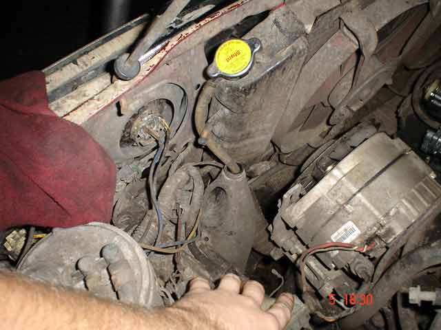

RavenTBK Posted January 5, 2005 Share Posted January 5, 2005 I think I have the same thing. Is it just a short (6 in. or so) small diameter hose which goes nowhere and just lets overflow out? If that's what it is, I'm sure that you could EASILY pop in a longer hose and mount an overflow tank - you'd be set. I'm not exactly sure how overflow tanks work (never had one) so, let me know if I just made a bunch of garbage up! Yep.. you're right on the ball. I had the same deal.. 6" hose going nowhere. So, after I changed the gear oil in my tranny, I re-used one of those bottles. I jammed it down the side of the radiator and framerail, and added a longer hose that would reach to the bottom of the bottle. Voila! Instant overflow bottle. Havent been low on coolant since. Quote Link to comment Share on other sites More sharing options...

RavenTBK Posted January 5, 2005 Share Posted January 5, 2005 So, with an overflow system, it's just a hose going from the radiator cap to a small tank. That's it? Does it create suction and pull from the overflow tank when it's low automatically?Yep. Actually, pushes into the overflow tank when it heats up, and sucks back as the coolant in the radiator cools. Not necessarily when its low. And I suppose, all I need is some tank w/ a cap that has a hose going to it (or make one) - right? I guess that I wouldn't need an elaborate cap if I just made sure the hose stayed below the coolant surface in the overflow tank . . . This sounds like a 5 minute project that will save me all the highway hours I spend pouring water into a piping hot radiator. Damn glad I started thinking today. (Thanks, RavenTBK) Now, by design, an overflow tank was not included. The Subie radiator will maintain the proper level of coolant automagically. The proper level of coolant is about an inch below the bottom of the filler neck...about 1/2 inch above the coils. If you need to add coolant to your radiator to bring the level above the core more than once a week, you've got other issues. The overflow bottle is just a band-aid to not have to add coolant as often. In a system thats without isues, the overflow bottle is not necessary, but it does extend the periods between topping off the coolant. Its since gotten dark outside. I still went out and took a pic of my setup. You can see the hose from the filler neck, dropping down into the gear oil bottle. Simple, yet effective. Lookie below. Quote Link to comment Share on other sites More sharing options...
MSSLGECKO Posted January 5, 2005 Share Posted January 5, 2005 Alright, thanks. P.S. In regards to your photo - I love it. Quote Link to comment Share on other sites More sharing options...
