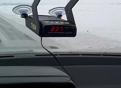

dj72 Posted January 15, 2004 Author Share Posted January 15, 2004 Yes the Tazzo is lighted up and yes i do put everything in pounds. I will go to the weigh scale and get the exact weight of the car with me in it, then i will do some testing as soon as i get ahold of my buddy with the Tazzo. Quote Link to comment Share on other sites More sharing options...

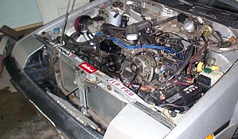

dj72 Posted January 15, 2004 Author Share Posted January 15, 2004 Here come the pics, the car is a little dirty due to the snow melting buts its the best i can do till it dries up around here. Quote Link to comment Share on other sites More sharing options...
dj72 Posted January 15, 2004 Author Share Posted January 15, 2004 pic 2 Quote Link to comment Share on other sites More sharing options...

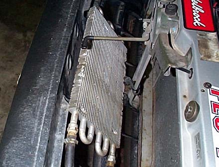

dj72 Posted January 15, 2004 Author Share Posted January 15, 2004 pic 3 Quote Link to comment Share on other sites More sharing options...
dj72 Posted January 15, 2004 Author Share Posted January 15, 2004 tazzo pic, this is the best i could do today because the tazzo works while the car is under load and i kept getting wheelspin which causes lower hp but not much, and this is WHP. On a dyno machine i won't be getting wheelspin nor will i have windresitance from driving so the dyno results should be the same but more likely higher. I don't expect hp from the oil cooler i just expect it to keep my engine temp low, and my cooler weighs maybe 3 pounds with the lines,filter, and cooler itself. Quote Link to comment Share on other sites More sharing options...

carfreak85 Posted January 15, 2004 Share Posted January 15, 2004 I can almost see that intercooler hiding behind that bumper and all those other mods through the hood too! is that the best you can do? Nice rice wing by the way! Quote Link to comment Share on other sites More sharing options...

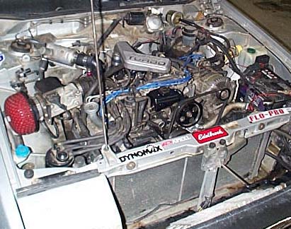

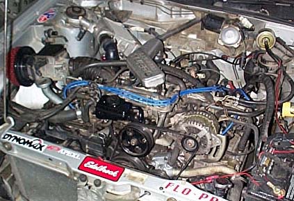

dj72 Posted January 15, 2004 Author Share Posted January 15, 2004 here are some pics of the engine and stuff, gotta get a better digital camera the pics are kinda blury. My front mount intercooler is getting fixed because of a nice stone, but i did micky mouse my old one in there for now. As for the wing it makes the ricers want to race more so i get to have more fun plus it does kind of look cool. Quote Link to comment Share on other sites More sharing options...
dj72 Posted January 15, 2004 Author Share Posted January 15, 2004 engine pic 1 Quote Link to comment Share on other sites More sharing options...
dj72 Posted January 15, 2004 Author Share Posted January 15, 2004 engine pic 2 Quote Link to comment Share on other sites More sharing options...
dj72 Posted January 15, 2004 Author Share Posted January 15, 2004 engine pic 3 Quote Link to comment Share on other sites More sharing options...
Dennis ex24 Posted January 16, 2004 Share Posted January 16, 2004 whoa dude, you totally drive an XT...wild, youre half way telling the truth now. thumbs-up. i didnt see any mounts for the FMIC in the under the hood shot by the way... Quote Link to comment Share on other sites More sharing options...
WJM Posted January 16, 2004 Share Posted January 16, 2004 neither did i, but I did see that there is some strange turbo plumbing. Quote Link to comment Share on other sites More sharing options...

dj72 Posted January 16, 2004 Author Share Posted January 16, 2004 All the plumbing for my front mount cooler are sitting on my shelf in my garage, its rather easy to take on and off. I just used pvc and intercooler hose so its easy to take off in times like when it has to get fixed. The one on there is basicly set up the same way but the ends were different so i didn't mount it in the same place as the other. Now here are my exact cam specs, intake-opens 30 closes 70 lift 336, exhaust-opens 70 closes 30 lift 336. The idle is kind of eratic, i don't know whether its the cams or the injectors causing this, but it doesn't matter beacause it doesn't effect performance whatsoever.These cams are built to my specs and if you don't have what i have, your engine won't perform or run correctly. This car is just an experiment for me since i have never done an import before. The hp will only rise from here cause this is not enough for me, i have been toying with the idea of adding a second turbo instead of a bigger one, kind of like the way they set up the sequetial turbo's on the mid 90's twin turbo supra's. But i will more than likely modify a bigger turbo onto the car instead, we'll see which one is easier when i get there. Quote Link to comment Share on other sites More sharing options...
