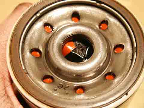

archemitis Posted January 24, 2005 Share Posted January 24, 2005 i just pulled this filter off o my er27. the damn thing tried to eat itself. the metal pulled away from the body, and was circulating unfiltered oil through my engine. it is a tough guard. it is the second time a fram has done this to me. my friend had a 300z motor suck all of the guts out, and cram his lower end with paper! in short fram sucks. alot. this wasnt user error, or anything of the sort, just a horrrible filter.. use purolator, or subaru! Link to comment Share on other sites More sharing options...
moshem74 Posted January 24, 2005 Share Posted January 24, 2005 i just pulled this filter off o my er27. the damn thing tried to eat itself. the metal pulled away from the body, and was circulating unfiltered oil through my engine. it is a tough guard. it is the second time a fram has done this to me. my friend had a 300z motor suck all of the guts out, and cram his lower end with paper! in short fram sucks. alot. this wasnt user error, or anything of the sort, just a horrrible filter.. use purolator, or subaru! hinext time order from where i buy oil filter's and sparkplugs, the best of the best: www.sparkplugs.com moshe. Link to comment Share on other sites More sharing options...
Patrick Posted January 24, 2005 Share Posted January 24, 2005 i just pulled this filter off o my er27. the damn thing tried to eat itself. the metal pulled away from the body, and was circulating unfiltered oil through my engine. it is a tough guard. it is the second time a fram has done this to me. my friend had a 300z motor suck all of the guts out, and cram his lower end with paper! in short fram sucks. alot. this wasnt user error, or anything of the sort, just a horrrible filter.. use purolator, or subaru! About ten years ago the exact same thing happened to my buddy with a Fram filter on a 305 in a Firebird. For about the same legnth of time I've been using Wix filters and have had pretty good luck with them, also good luck with Puralator, too. Sorry to see that, hopefully nothing was too badly affected. Link to comment Share on other sites More sharing options...
mudduck Posted January 24, 2005 Share Posted January 24, 2005 I have always used fram filters, but after seeing that picture and hearing a few bad stories about them lately, I'm gfoing to go with somthing else. Link to comment Share on other sites More sharing options...
spanky_pete Posted January 24, 2005 Share Posted January 24, 2005 My turbo wagon had one of those on it when I got it. It was crushed where they had used a strap wrench on it. But the really funny part was the crush washer that goes on the drain plug had been put on the inside of filter instead. Napa gold filters are the only kind I use. Been using them for years on all my rigs and have never had a single problem. Link to comment Share on other sites More sharing options...

88rxsedan Posted January 24, 2005 Share Posted January 24, 2005 ive used nothing but fram filters for ever, but after seeing that i think ill switch to a different brand.. although, that could of happend to any filter Link to comment Share on other sites More sharing options...
JWX Posted January 24, 2005 Share Posted January 24, 2005 fram as been crap for years, its a quality control thing. but if you change it out at 3K, I don't really see this happening. how many miles were on the filter I use wix filters Link to comment Share on other sites More sharing options...

rallyruss Posted January 24, 2005 Share Posted January 24, 2005 fram wastes all the funds on advertising and makes up for it by putting out a crappy proudut. my fatherinlaw insists on using them because they are cheap. drives me crazy. yeah there is no question that fram is junk. just cut one open and see how its made compared to a wix or other Quality filter. Link to comment Share on other sites More sharing options...

4WDFrenzy Posted January 24, 2005 Share Posted January 24, 2005 Son of a...............?!!! Now that really hacks me off!!! I have one of these on the good ol' Draggin' Wagon right now! Well, I know a car that'll be getting an oil +oil filter change wit da quickness!!! Link to comment Share on other sites More sharing options...

stephenw22 Posted January 26, 2005 Share Posted January 26, 2005 Are there any good filters with synthetic media? When I worked for Detroit Diesel back in tha' day, they made them for their Series 60 engines, and they were WAY better than conventional (paper media) filters. It trapped particles down to 1 micron instead of the usual 10 microns. They did some studies and it showed that there was a significant drop in wear (at least on a new engine) vs. using a conventional filter. As far as which brands are best, it seems like you just get what you pay for. The low-cost filters are cheap for a reason. Most are made by only a few manufacturers anyways, and just re-branded. Link to comment Share on other sites More sharing options...

rallyruss Posted January 26, 2005 Share Posted January 26, 2005 Are there any good filters with synthetic media? When I worked for Detroit Diesel back in tha' day, they made them for their Series 60 engines, and they were WAY better than conventional (paper media) filters. It trapped particles down to 1 micron instead of the usual 10 microns. They did some studies and it showed that there was a significant drop in wear (at least on a new engine) vs. using a conventional filter. As far as which brands are best, it seems like you just get what you pay for. The low-cost filters are cheap for a reason. Most are made by only a few manufacturers anyways, and just re-branded. Wix made them for a while but they did not sell well due to the price so they droped the line. they were sold as "sport truck" filters. yeah sweet82 penzoil is crap as is the filters they sell. I belive they are just a Fram in a yellow can. Link to comment Share on other sites More sharing options...
